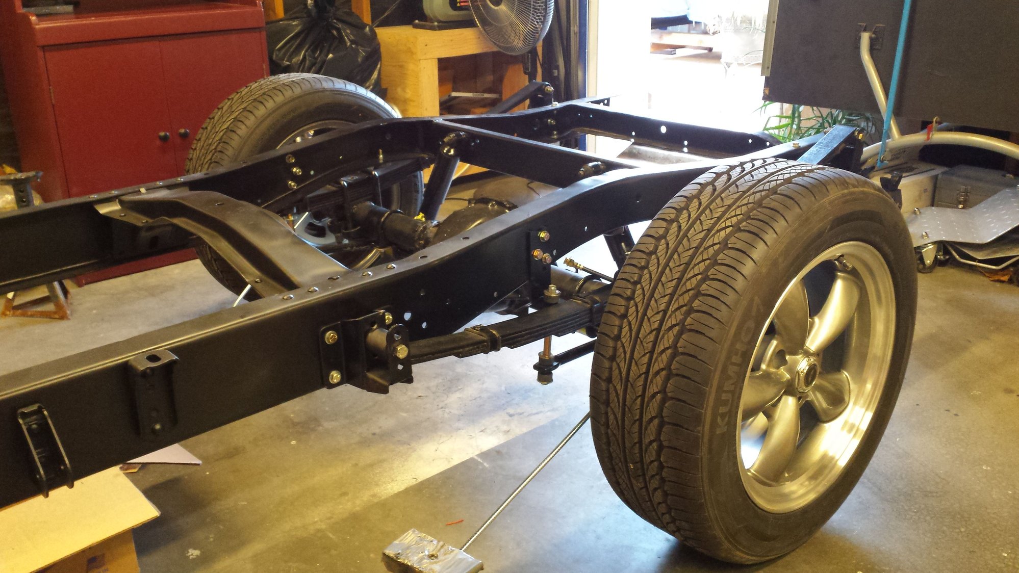

Guys. Managed to get the new shackles in there with a lot of help from my brother, who gave me lots of advice and assisted with, well, practically everything.
I have documented the event here. no point in repeating the same stuff I guess.

Yeah you want to do the frt one like this.
And if you want lower, move the bracket up higher on the frame.

Yeah. I told him that but he said he thought it might sit too low compared to the front. I've got the guards back on again now and it looks a bit better than before, but I might reverse them around when I strip it all down next year for a respray.
I'll put a pic up later to show you how it's looking. See what you reckon.

here's a before and after. Before up the top. Slight improvement, methinks.
