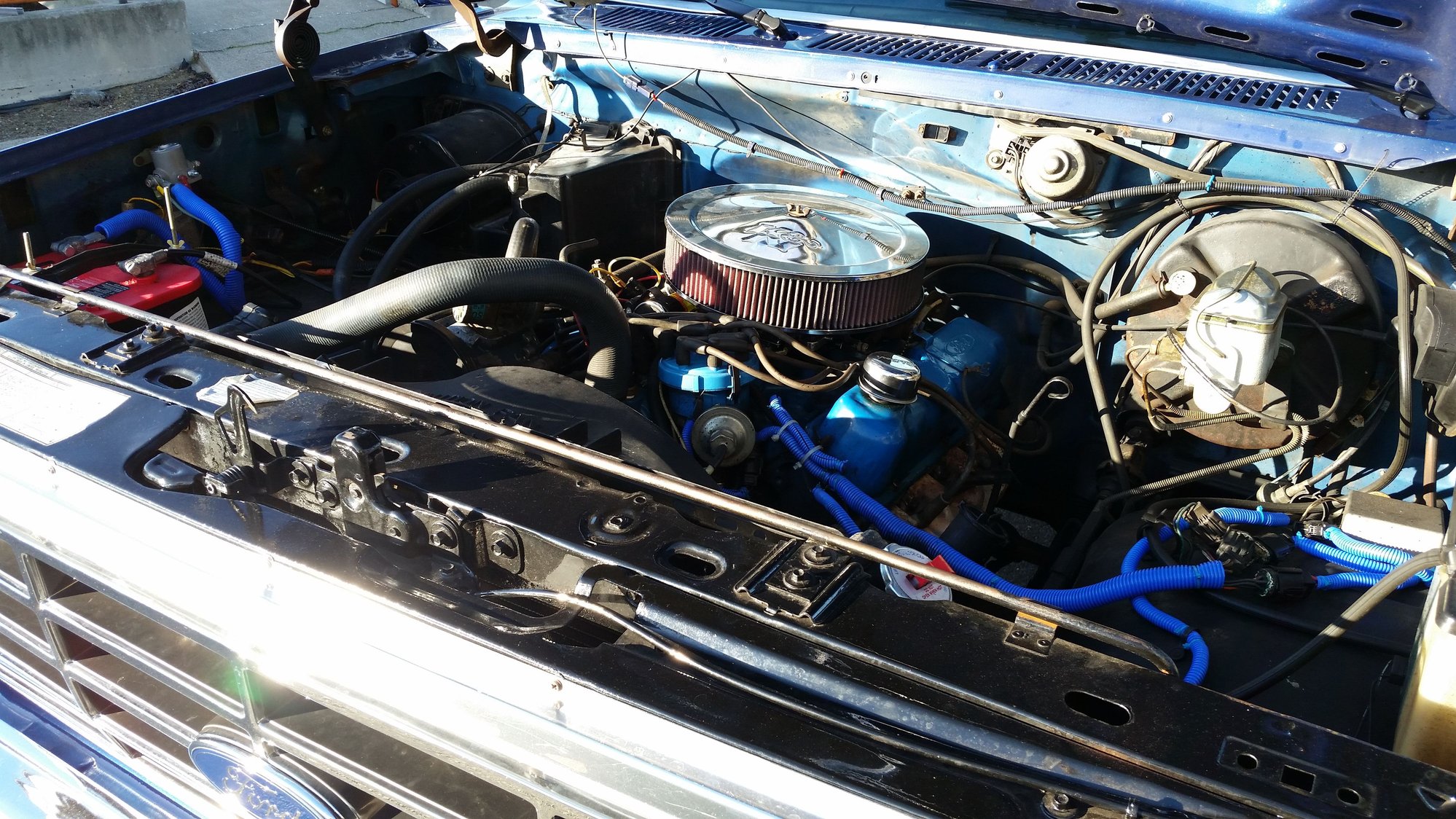

It needs a couple little things: The steering wheel has a lot of slop in it, it idles like **** when it's cold, and it runs a little hot while sitting in traffic. Aside from that, its awesome! Can't wait to take it camping.

Noticed the vent tube for the rear axle is missing. Might want to get one on there.
The idling could be as simple as a choke adjustment...if you need one in Cali.
For the cooling, first put in a Motorcraft thermostat, and check to make sure your fan is pulling enough air through the radiator. May be a bad fan clutch also.

The cold idle could be choke adjustment or not having warm air from the exh manifold heating the incoming air because of the open air filter.
Running hot, after checking Tstat and fan clutch check the flow thru radiator. Warm up motor and turn it off then feel the fins all across the face. It should feel hot across the whole face if you have some cool areas you are not getting flow thru that part.

Missing vent tube.... Whereabouts should that be located?
Regarding the poor idle: Yesterday I found a significant vacuum leak. I just taped over it for now (going to get some vacuum caps today) and the bad idle problem immediately went away. Now on a cold start up it fires up in about a half second and purrs along at ~800rpm.
There's a hodgepodge of vacuum lines and stuff all over this motor from smog related things. The guy I bought it from had a shop do all that so it could pass smog. I think I'll end up just taking most of it off (taking pictures so I can reverse it later).

I flushed the radiator today and what came out was pretty nasty. Got that all taken care of and now it runs cool, with no noticeable problems so far. I'll keep an eye on it to see if the situation worsens over time.

There should be a hose that connects to the brake hose "bolt", circled in red. From there, it goes up to the frame and is held on by a metal clip. There is also a vented cap that pushes into the hose. That will help to keep any debris out of the axle, and let it vent without any leaks.
Good to hear it was a simple fix to get it running better and hopefully cleaning the radiator did the trick too.
