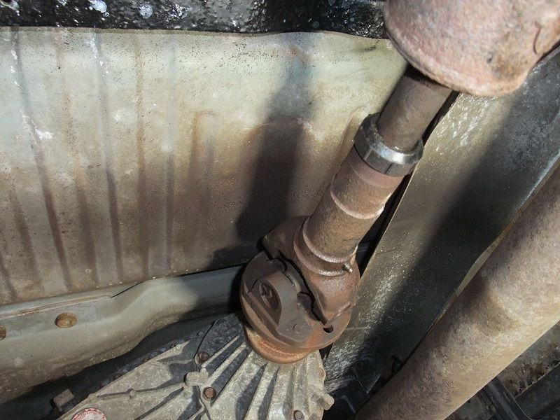

Does the stock Ex driveshaft not have a zerk fitting so you can grease the splines ?
I give my ujoints and slip joint zerks a shot of grease every time I rotate tires. Just part of my maintenance routine and only takes a few minutes.

I'd think a person could add one easy enough.
My driveline guy has always put them on my shafts.
Guess I have never owned a non lifted vehicle long enough to realize they didn't come with zerks any longer. LoL

Originally Posted by weeeves
Mine has a zerk also. I'm pretty sure it's stock.
Hmmm, Curious
What year ? Can you post a pic ?
I am just curious if they maybe they stopped using them and if they did maybe they started using a different spline coatings or what.

Originally Posted by pirate4x4_camo
Hmmm, Curious
I'm glad you asked because I just realized my boot is MIA
2000 7.3L 4x4
