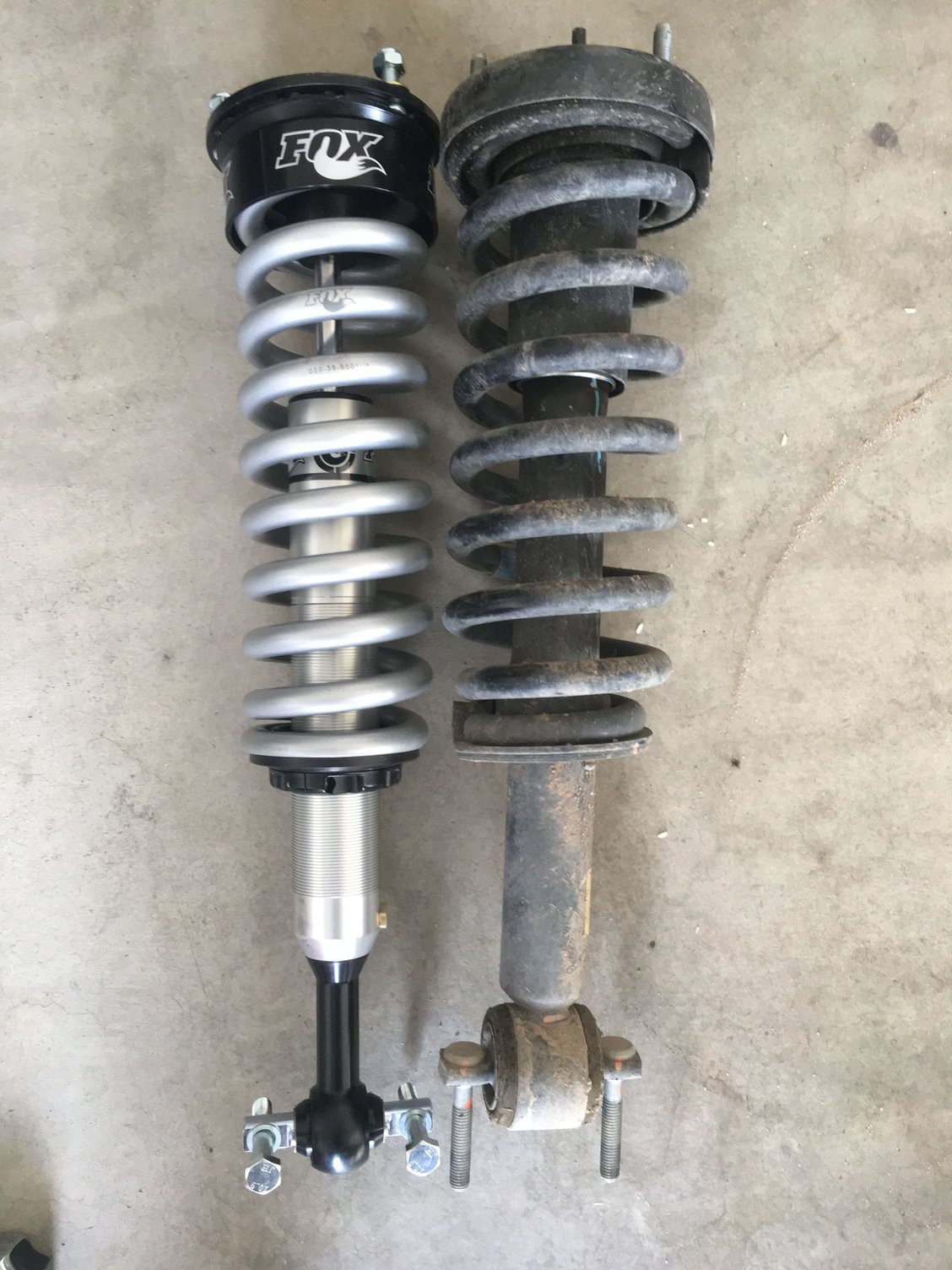

I'm thinking on buying FOX 2.0 Performance Series Coil-Over IFP Shocks for a 2014 4x4 front coil-over for my 2014 XLT 4x2..
anybody has/had any experience with them on a 4x2?

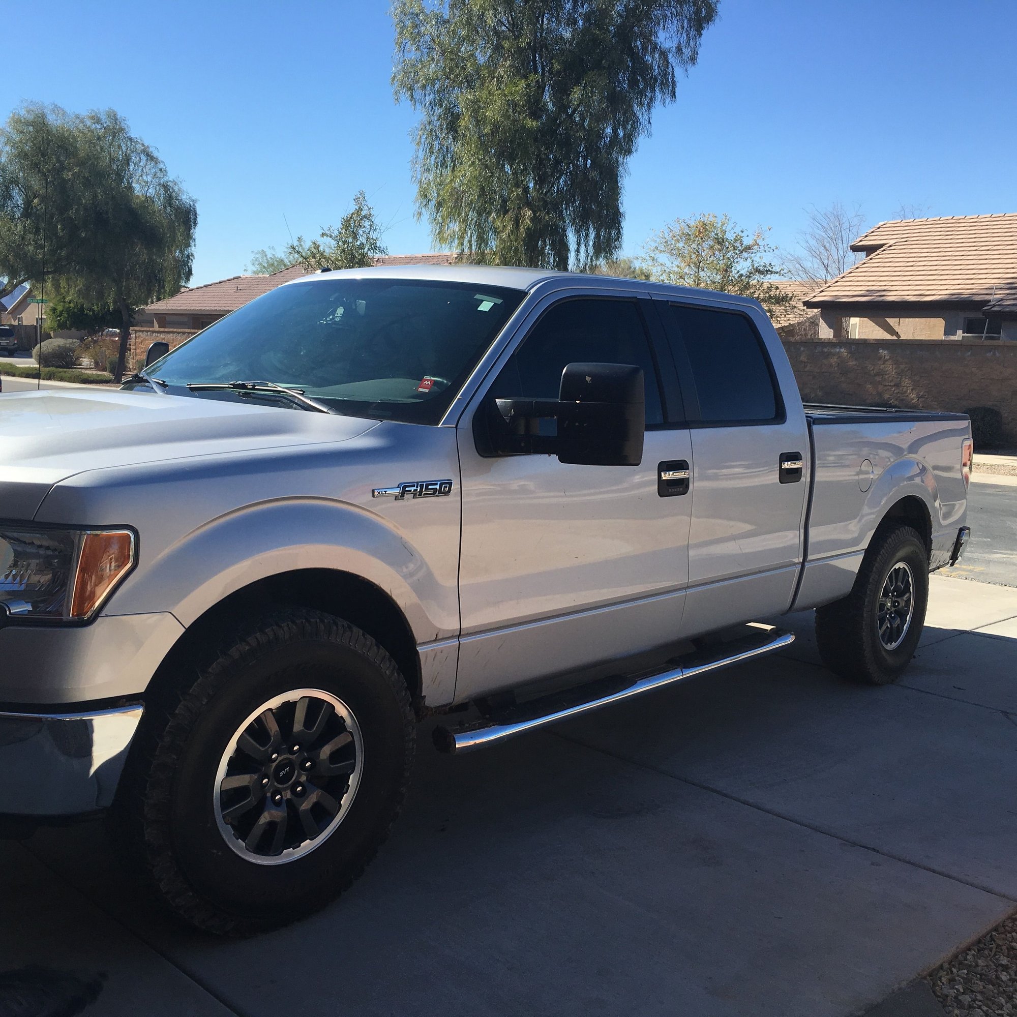

Old Mar 4, 2016 | 09:15 PM
krazymarine's Avatar
krazymarine
Joined: Jan 2004
Posts: 48
From: Queen Creek
As promised!!!

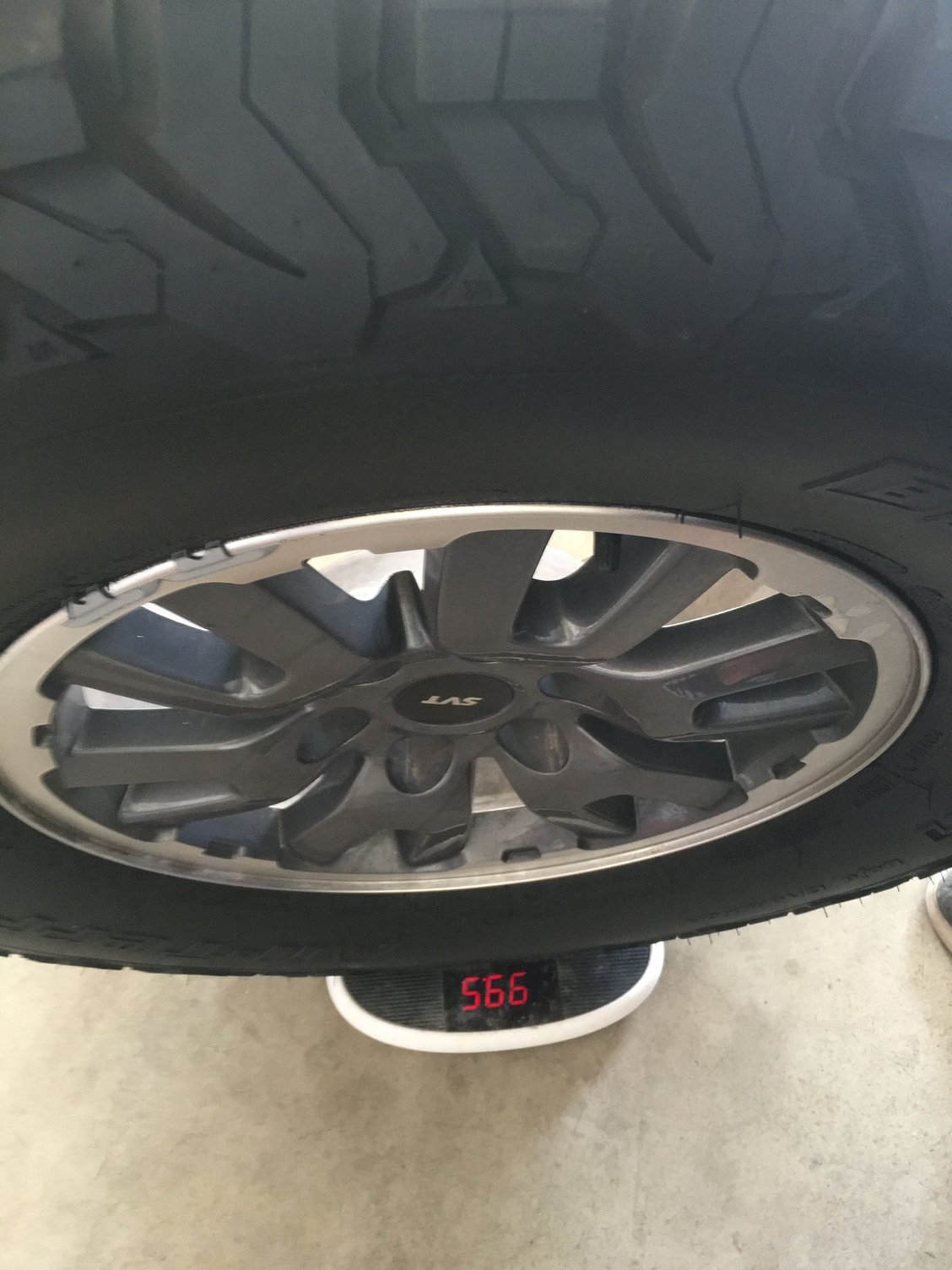

KO2 with Raptor wheel weight
