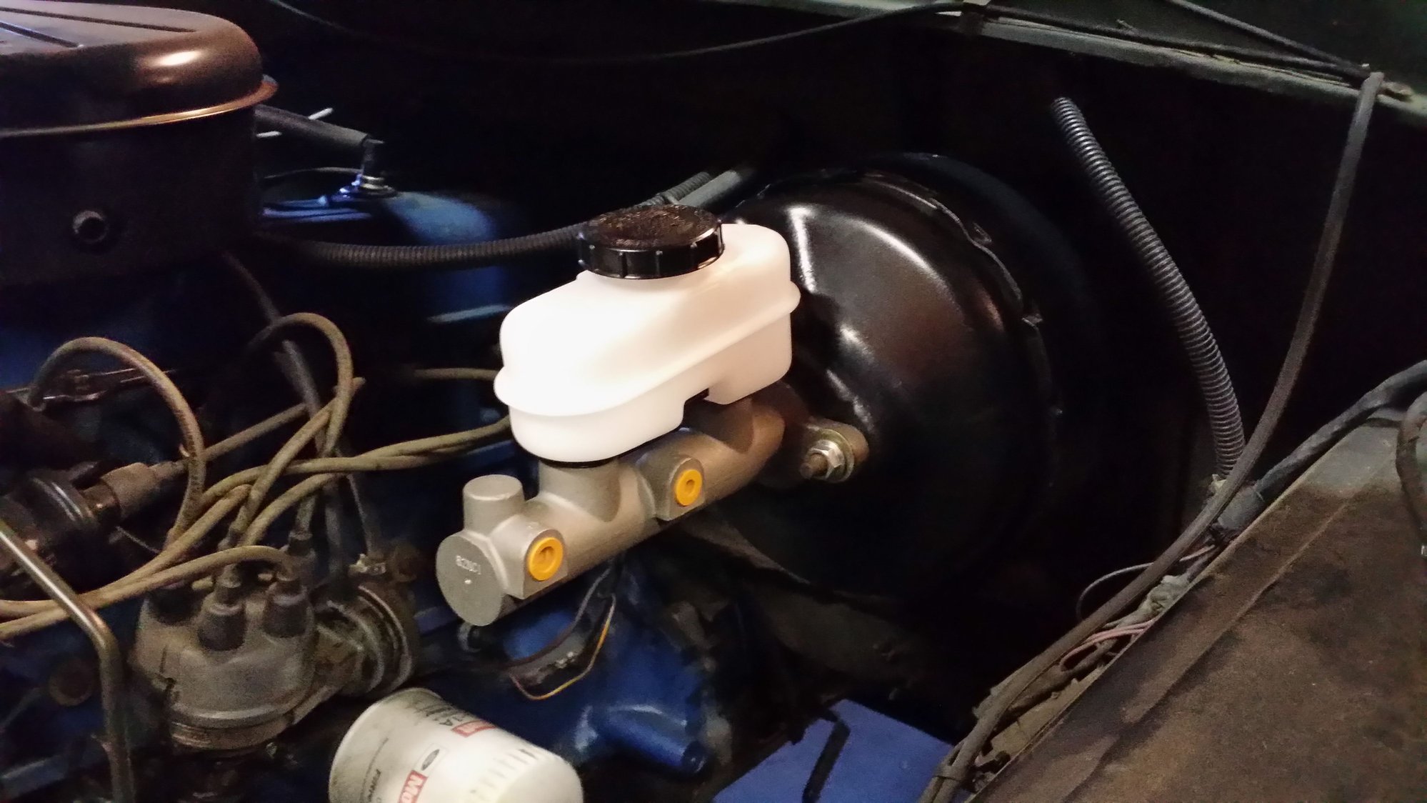

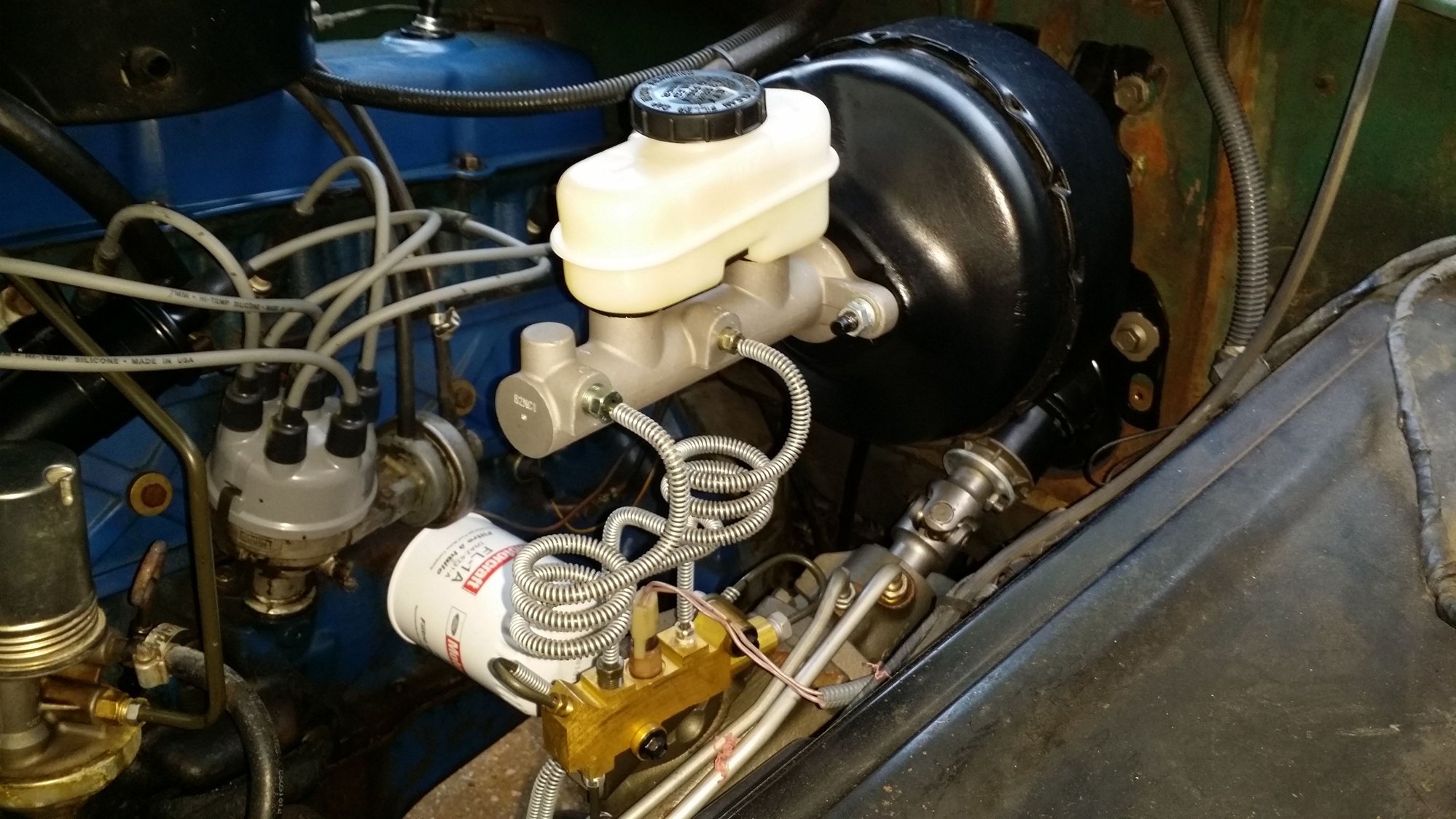

I have a 1-1/16" bore MC for a 1995 Ford Explorer on my '69 F100 (currently with '77 F100 front discs and stock '69 F100 rear drums. --I have an '81 F150 9-inch rear end with the 'Torino' style large axle bearing housing flanges that will eventually allow me to bolt on '95-'01 Explorer rear discs to the '81 9-inch rear end housing).
'95 Explorer MC on a '75 F350 dual diaphragm brake booster.
1984-'86 F150/Bronco Ford/Weatherhead OEM disc/drum brake valve.
