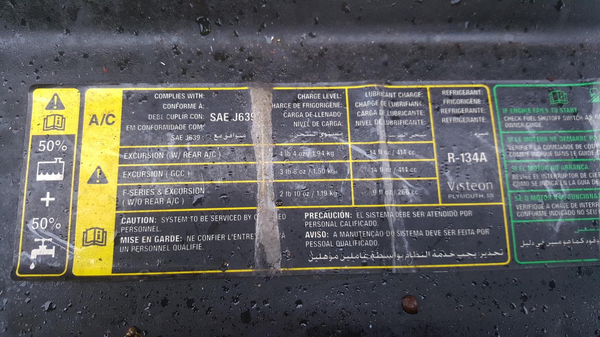

There should be a sticker saying what type and the charge by weight of refrigerant. This is on a 2004 F350 w/5.4L gas engine.

Old Feb 24, 2016 | 05:49 PM
allenhillview's Avatar
allenhillview
Joined: Feb 2016
Posts: 72
From: East Tennessee
Thanks to all who shared, I do know our 95 accord still had R-12 in it, that conversion included a lot of parts besides the port retro-fit kit. Thanks again for peace.
