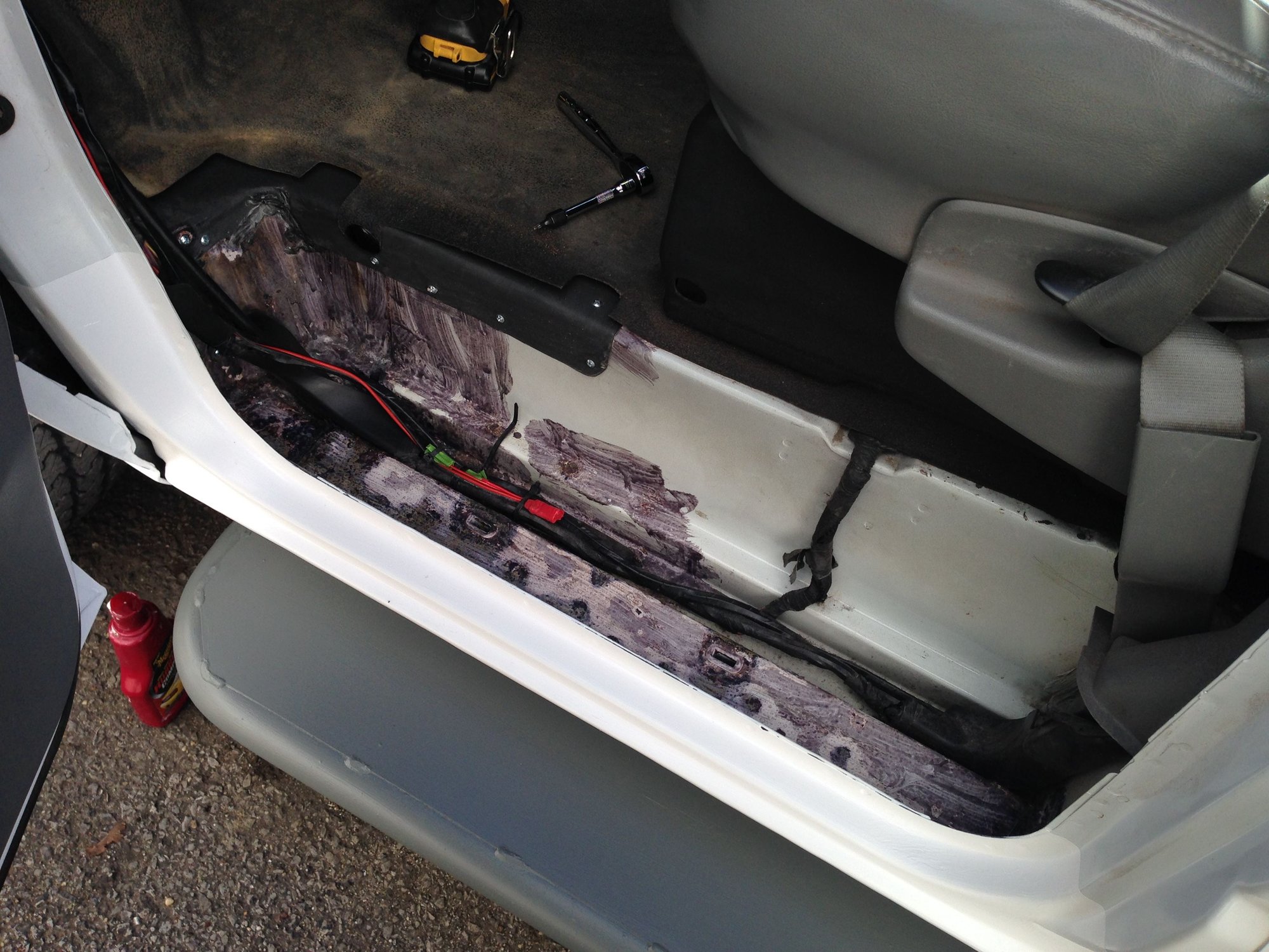

Its a rookie job but got it done. Grinded out the rust, rust converter on the rest, sheet metal for the floor, body filler, prime and paint.
