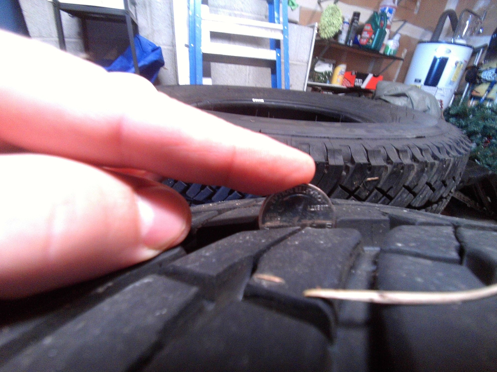

Not to throw this off topic but. Keng, I still have those Michelins. Here are some pictures for you. If you are still interested, let me know.
