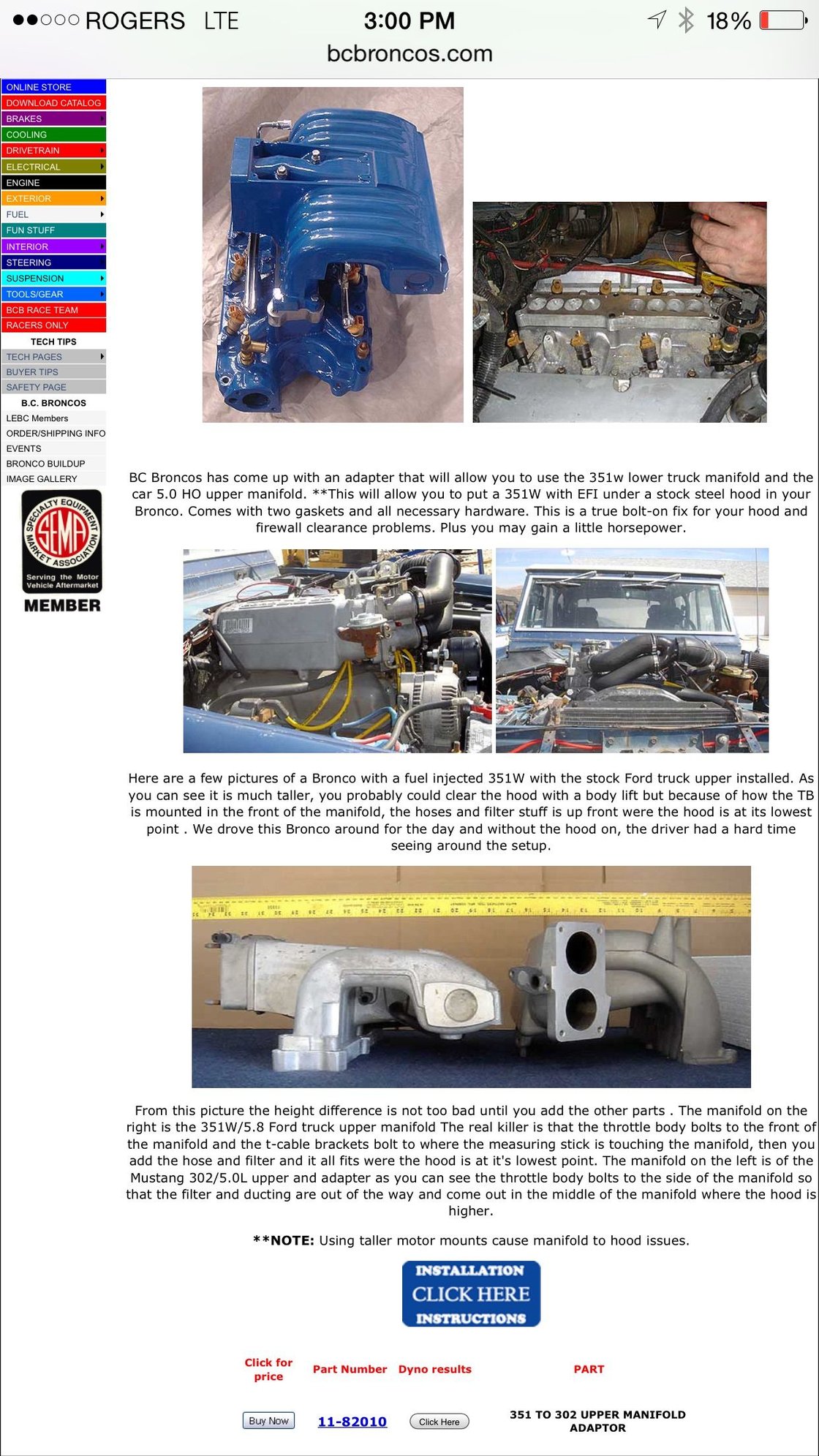

cheapest, and one of the most effective routes, is getting adapters to run a 302 intake on the 351. the truck 302 intake is very good and can be gotten for close to nothing, adapters are something like 200-250.
Intake Adapters
not trying to be antagonistic, but the 351 truck lower is the worst piece of trash produced for the efi sbf's and is the largest choke point of the 351 intake.
X2....amen
Intake Adapters
When I checked on the adapter price a couple months ago, it was around 300 to 319, I believe ... not disagreeing with the other points .....
Intake Adapters
HMMMM see I need to get my truck dyno'd as it sits currently with the stock intake and perhaps pick these adapters up and run the stock 302 intake I have sitting around and see the difference. 5.8 intake is garbage. I wonder how high that guy was at the assy plant when those intakes were produced.
