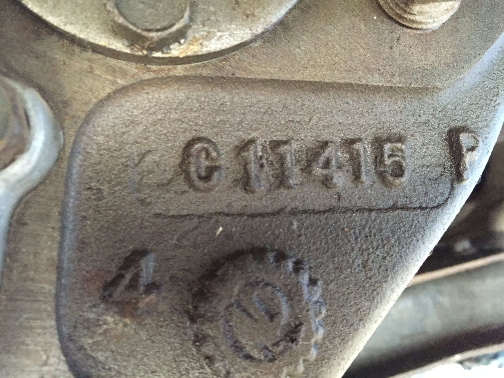

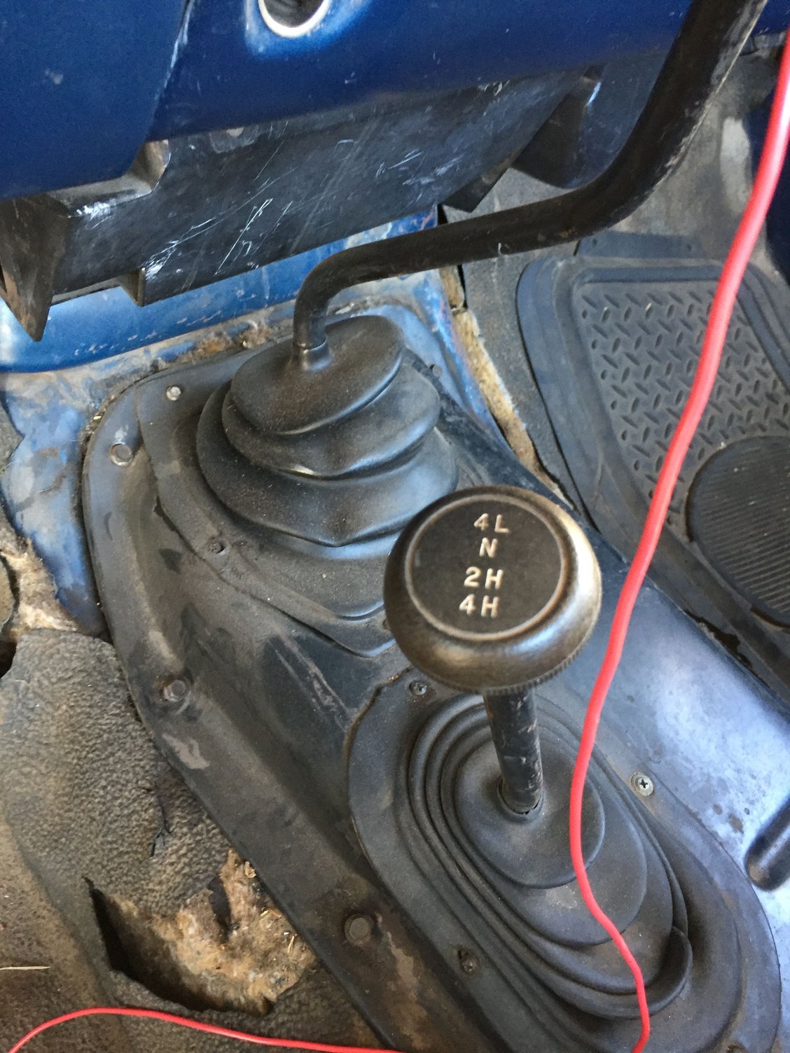

So I have a nice leak going on here. I'm pretty sure it's a 205 but just to be sure before I get the gaskets and seals. Can anyone help?

Crawl around to the other side of the xfer case and look for a blue and silver tag. Your xfer case shift pattern looks like a NP-205.
NP-203 on the left NP-205 on the right.

It's a 205 confirmed by the three-bolt pto cover on the rear below the output shaft and the shift pattern.

Thanks for the help! I'm gonna go ahead and guess it's the original one?

The TC is very rugged, unless someone ran it dry for a while theres really no killing one. I would suspect its original. Are you going to replace the seals with the TC in or out of the truck?
