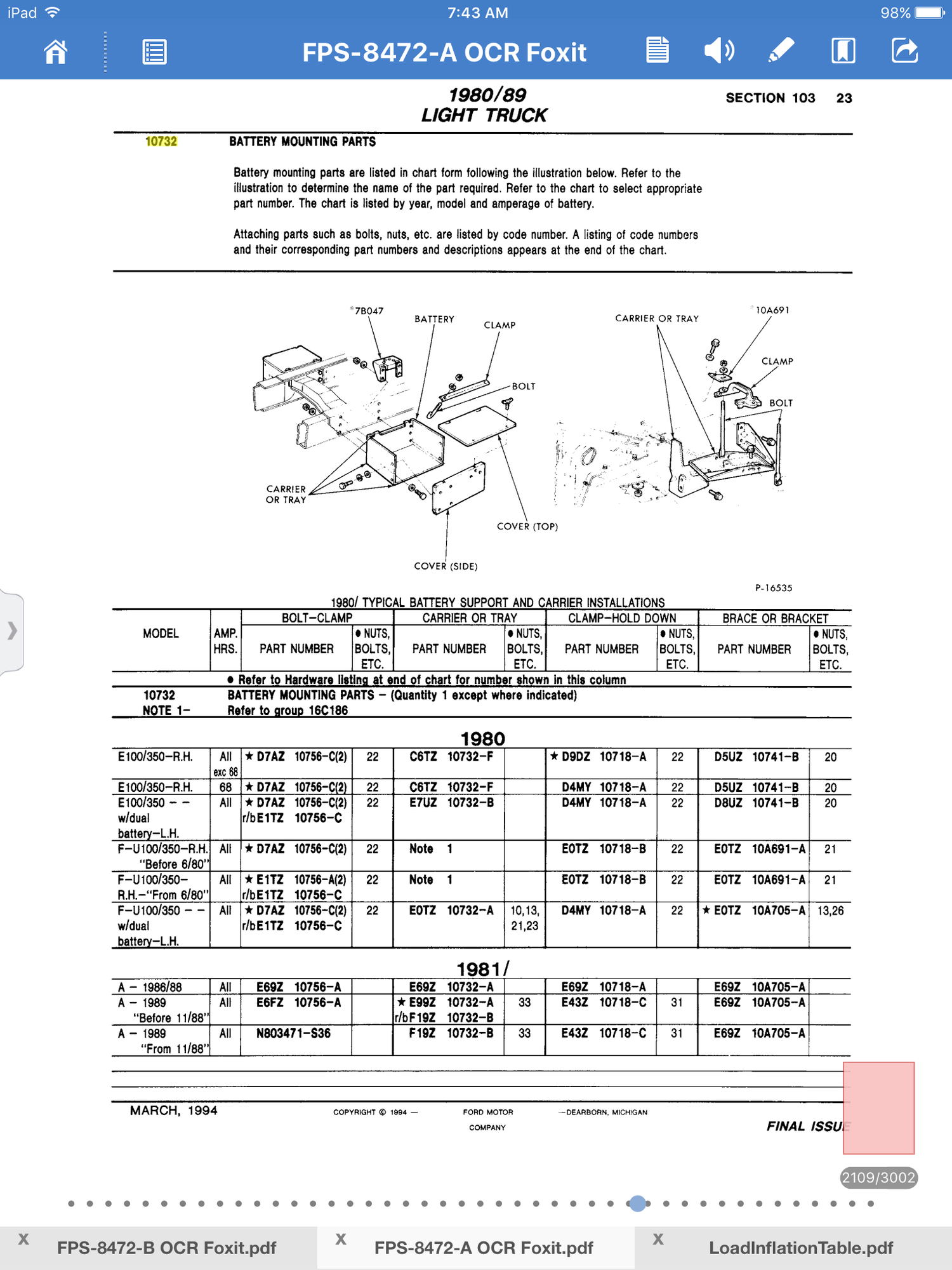

I originally picked this up in a lot of NOS parts and just figured it was truck since it was with a lot of other pick up parts. I have did several google searches trying to figure it out to no avail. I figured maybe NumberDummy or someone else on here might be able to give me the information. I was going to modify it as I need a battery tray for another vehicle but hate to mess up a NOS part someone may be able to use. Part number is E0TZ 10732A Any help would be much appreciated. Will post pictures this evening.

I don't believe it fits these pickups. 10732 appears to be the # for the whole battery holding system, but as you can see in the attached pic, our part numbers start at 10756 and go up.

I had considered it fitting vans as well. I did a lot of searching with the 10732 part number and it fits a TON of vehicles as it seems to be a tray number. I will take a picture of it now.

I'd guess it's for a sedan and not a truck/van/ranger/bronco II

"E" in the above means full-sized van. So it doesn't fit them, either.
In WHAT above? The E I see him telling us (E0TZ-blahblahblah) means 1980s

I don't see 10732A anywhere

It looks to me like it is listed under dual battery LH in 1980

A search of the catalog gets zero hits if the A is included. And w/o the A it comes to the above page, but it is just the group.

It shows an A above where I said

Well, I sit corrected. I needed to add the "-" between the 10732 and A. Sorry about that. And, I missed the multiple columns.
