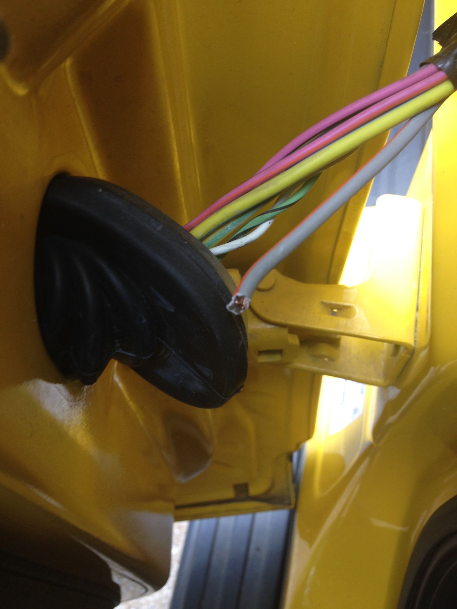

my 2006 f150 fx4 super crew power windows wont go down on the passenger sides. the driver side works fine. i went the owners manual and changed our the fuse in the fuse box and same thing still. just to make sure, i put the fuse and tried the driver side and it did not go down. what could it be? should i just take to one of the local mechanics and have them look at it?

Check for a broken wire in the wire bundle at the driver's door hinge.

i second the recommendation to check the door jambs...
just pull the boot back and check the wires.
