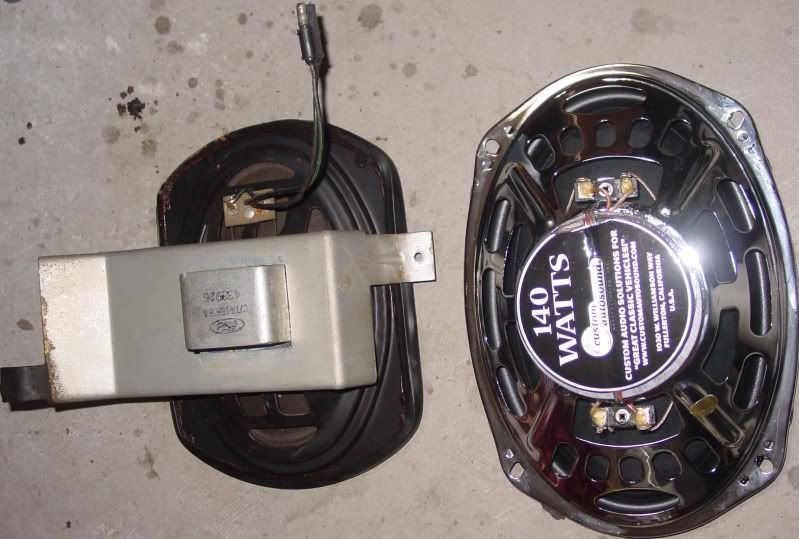

Please see the first two pictures below. This was from an unfortunate gentleman that ordered the LMC "Replacement" only to find out that it was far from a plug-and-play.
The third picture is the Turnswitch.com 6x9 speaker. You can see what Greg is talking about. I believe because of its smaller diameter magnet it will drop right into our original bracket. It also comes with a fabric dust shield to prevent debris from vibrating on the cone.

Note Gentlemen. This is a single voice coil speaker. AKA Mono. It would be perfect for a AM mono radio but not for a stereo aftermarket radio. Multiple channels. High output aftermarket radios usually have a "floating ground". So they wouldn't really like hooking both front channel positive and negative wires to this one speaker. It may work, but that will be hard on the aftermarket radio's internal amplifier. Notice how the ill fitting LMC speaker has two sets of wire connections.

says that it is 8ohm so you can wire it in to get the standard 4ohm of most car stereos.
