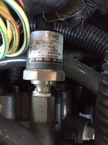

This is a pic of the new one I installed last spring, the older ones were brass colored.
Edit: To the OP, my symptoms were different than yours when the sending unit failed. My FP gauge would jump around then read high when it wasn't bouncing around. But it wouldn't hurt to call them and ask.
