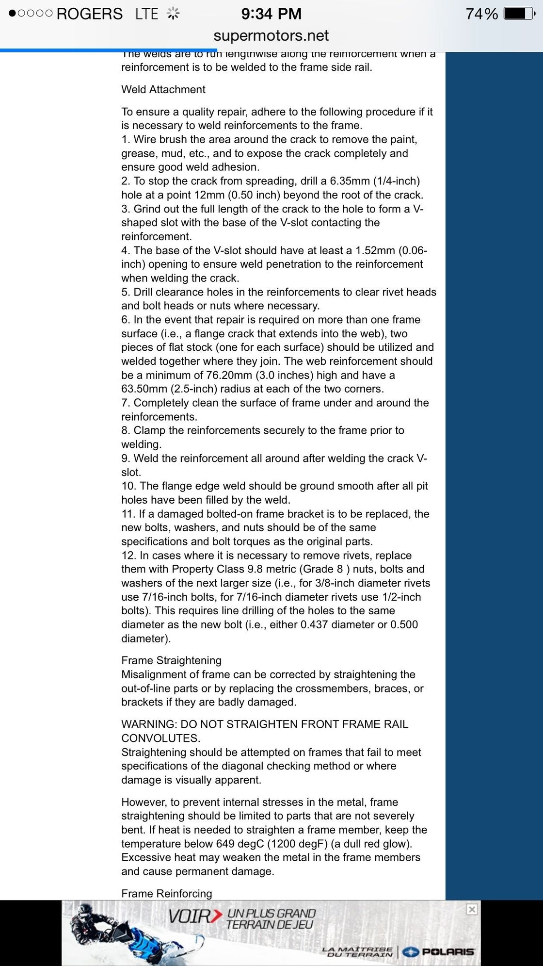

1983 Ford Bronco Diagrams picture | SuperMotors.net

If you read the link it will tell you how

IMHO, if the frame is damaged at all, and the sheet metal on the truck is good, I'd swap it over.

we never heat the frame to pull. just hook it up to a frame machine and pull it straight. when you heat it it weakens the steel.

like i said, a frame machine will pull it back to where it should be. we have repaired thousands of crumple zones over the past 25 years at the body shop.
Agreed 100%
