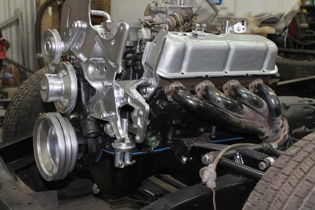

Matt; I tried the shorty's and the wouldn't work right with the straight axle. I bought the block hugger's from Speedway, and bought their header extensions. I had to cut the extensions down, and expand the header flange to fit. Welded the flange pipe to the extensions. It worked better than expected. Good luck

Yamagrant What is the stamped number next to your power steer pump? Is ti another place for vin or did you stamp it in ?
That's a Canadian stamping, mine's in the same place.

John's correct. that's where us Cunuck's had the vin stamped. My frame, I believe is a 54. ( found out the hard way installing 56 rear spring's from Posie's. I had to move the rear spring perches 4'' back ). Up here a body stamping is all we need to register. Good luck.
