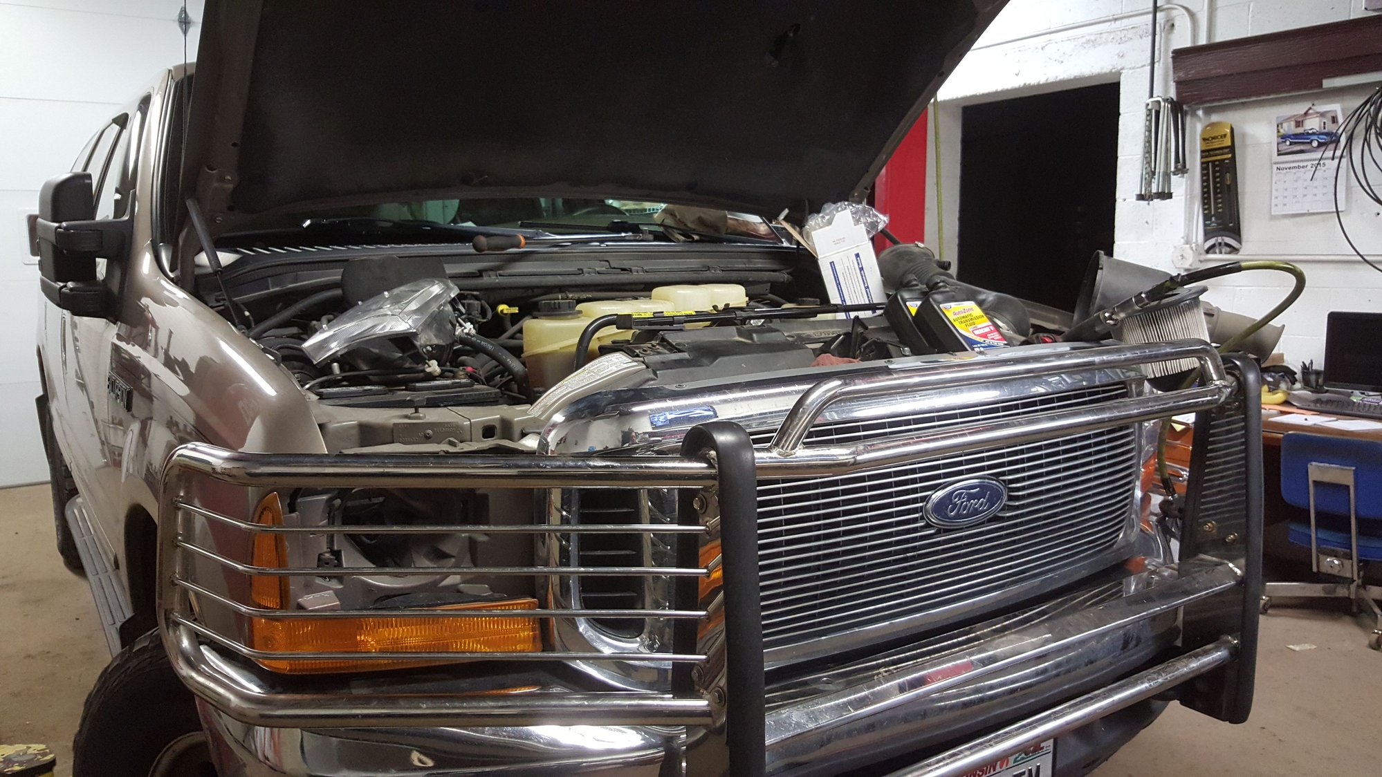

Front marker kicking butt help
Okay
Replace the little bulb they said
Ten minutes they said
Help

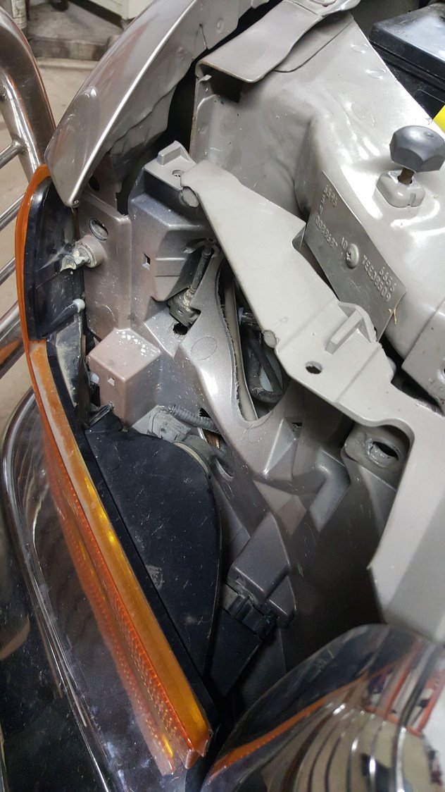

Old Dec 11, 2015 | 10:25 PM
pirate4x4_camo's Avatar
pirate4x4_camo
Joined: Apr 2011
Posts: 8,259
Likes: 346
From: Northern California
See pic for location of tabs that the Phillips screws are holding on.

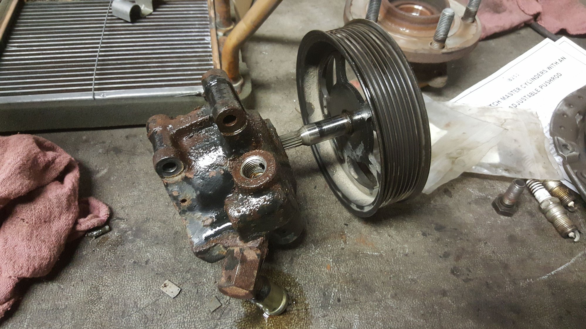

That took longer than the pump I was working on
