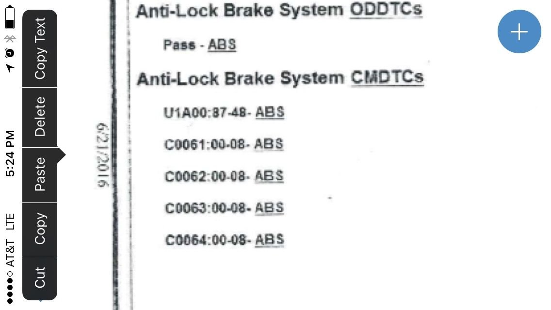

I have a 2015 F250 with 27K miles I have had it to the dealership 3 times for "service advance track" warning light over the last three months. First time they dug into the wiring harness and tried to make sure everything was connected. Last time two weeks ago, they ran diagnostics and cleared several diagnostic warning codes. This time they ran a diagnostic check and cleared codes again. Usually occurs under normal conditions. Sometimes it clears itself, only to come back on the next time I start the truck. Any suggestions?

Clearing codes from the module is not repairing the truck. Go somewhere else. At the very least do you know what the codes were?
Here are the codes they gave me on the second trip. This time they said they did an IVD initialization and retested it and it passes. I am betting it shows up again within the week.
