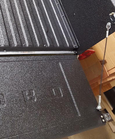

I used seat belt latches and F150 tailgate cables.

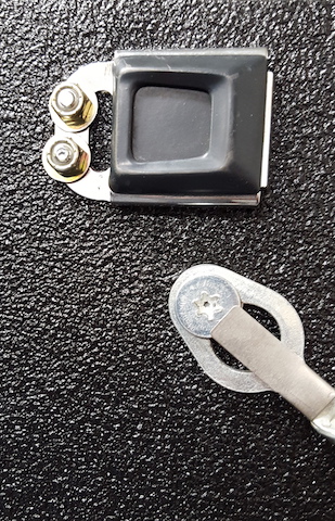

Originally Posted by fatfenders
At your convenience I'd like to see a closeup of both ends of the latch fab. Some of the available kits just have too much or a utility hardware look for my liking. My gate was shut for years with a couple small SS L brackets and polished buttonhead screws. Very clean but not exactly handy as it took about two minutes to open and close the gate. I really only open the gate for bed cleaning though.
Cut the belt off and holes drilled for the bolts.
Cut off and welded to a flat plate for mounting.

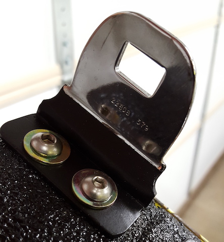

My solution:
Attachment 129191
Attachment 129192
Here is another install of seat belt latching of the tailgate.

Originally Posted by 49willard
My solution:
I just bought a set of these high dollar latches for my truck after being disappointed by the Mar-K spring loaded latches. Again, I was disappointed to find that if I actually install them, the screws will stick out visibly on the outside of the bed side. I've seen plenty of pics of these in use. To the guys who are using these, can you post a pic of the bed side, or tell me how you avoided having the screws sticking out? Thanks
