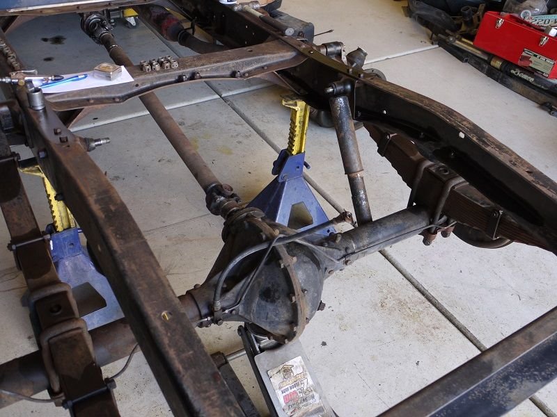

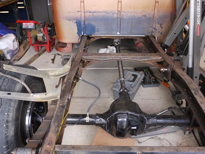

Her's my 52 F3 after having the drive shaft shortened. The slip joint was slid back 1" stock and I made sure it still had that when it was shortened.
Do you still have the original Timken diff? If not, that may be your problem. I had to take about 2" out for the Dana 60.
You could probably cheat and slot the carrier bearing holes a little for the front section. The rear has to have some room in the slip joint though. If it has none at all it may be pushing so much the carrier bearing can't line up with the mounting holes.

Here's the original Timken Diff.
