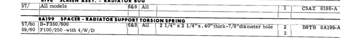

After a little more checking, my memory is correct! The pads are the same.
If you plug that part #B9TB-8A199-A in the web you will find NOS and new pads are available!

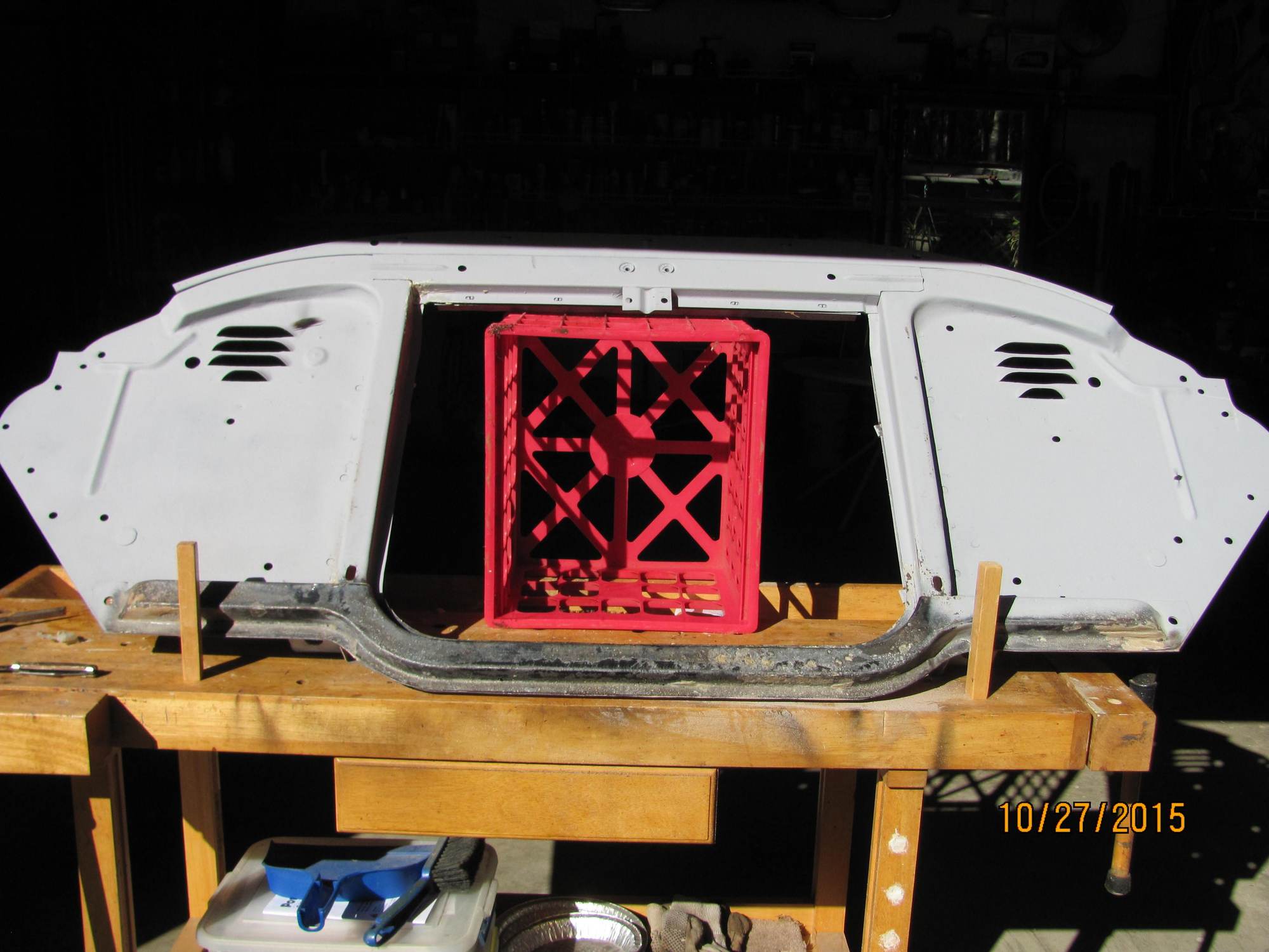

Thanks a million for the part number. So far, the radiator support has been the most difficult and time consuming to repair. I could not locate a replacement. It looks real good now. I'm going to put a base coat of paint on it and move on. It's getting cold so the work will slow down a bit. Get the hood into my garage and work on it during foul weather.
May be the hardest part in the world to locate.

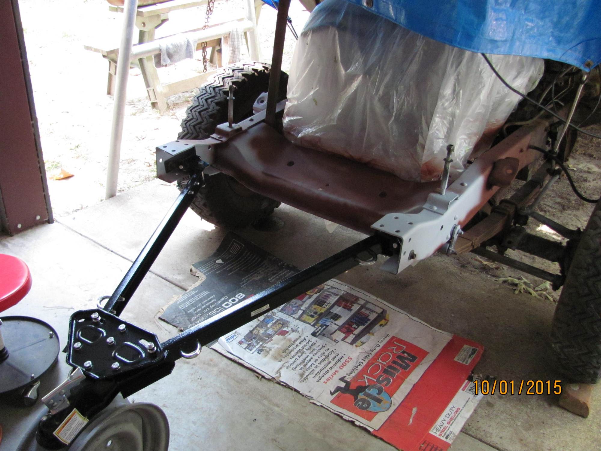

New tow bar to haul the hulk around.

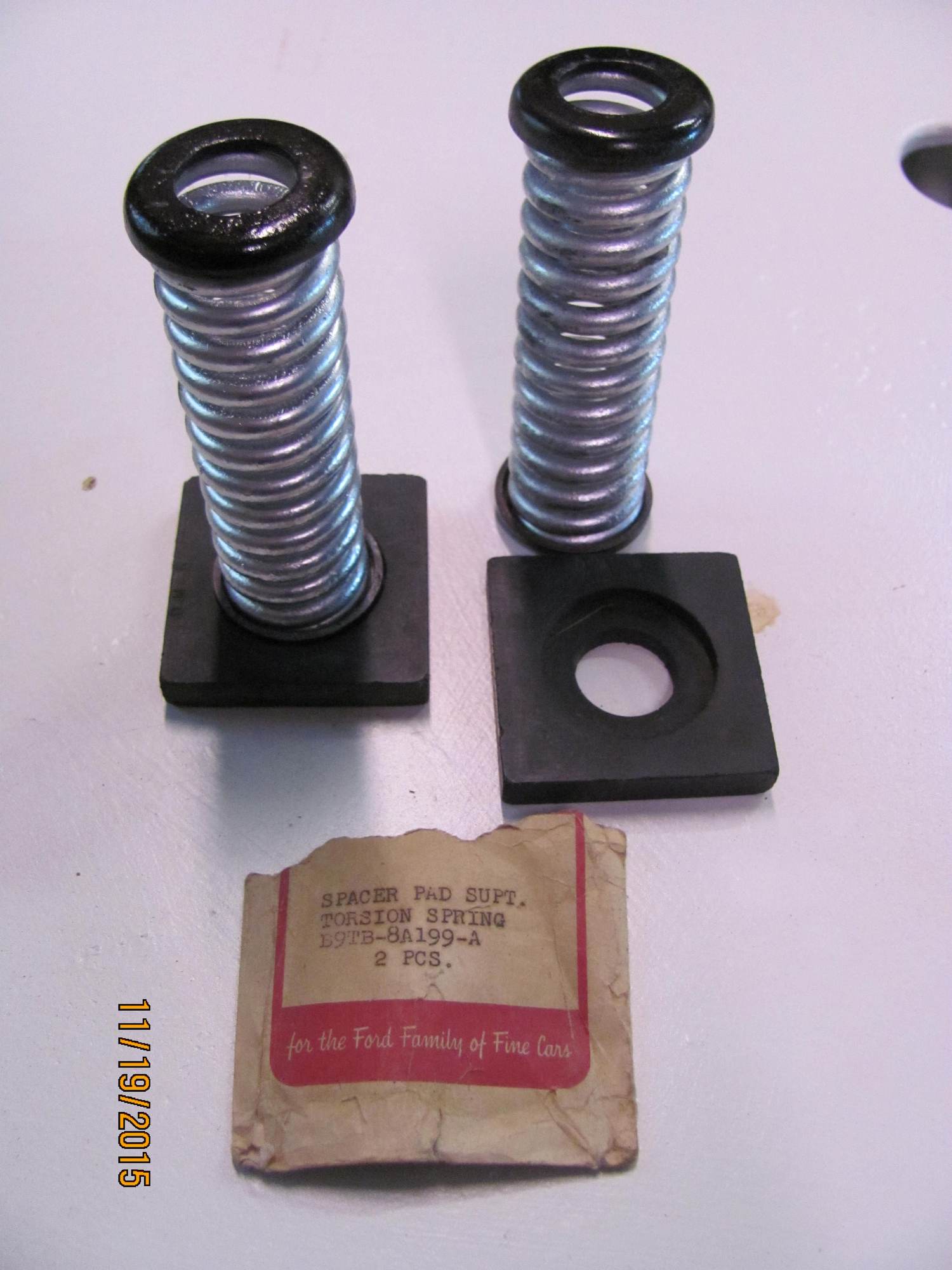

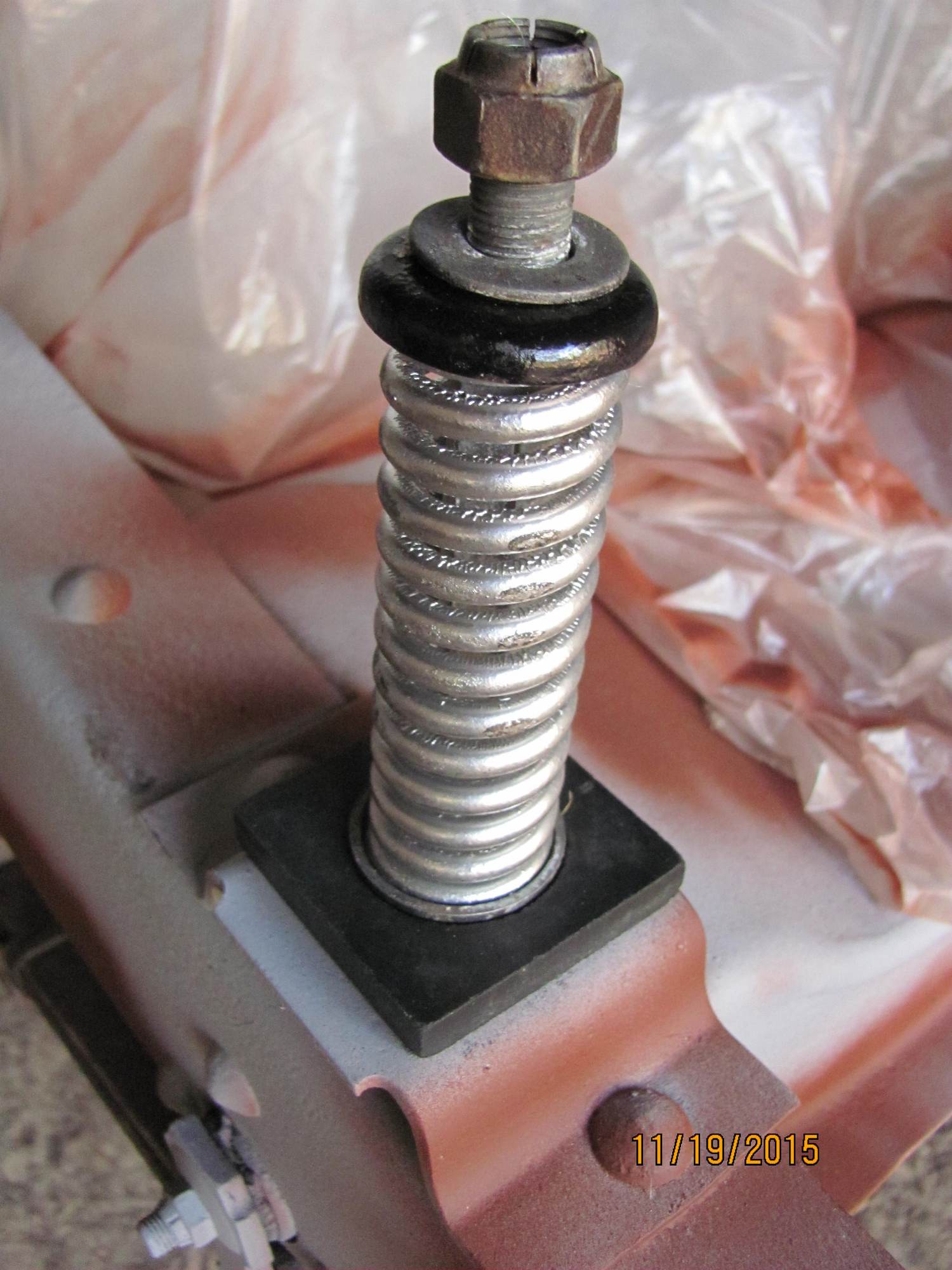

Radiator support pads
Received my radiator support pads today from Green Sales Co. in Cincinnati OH. Good price and quick delivery. They even sent the label from the original packaging.
Thanks to all for pointing me in the right direction!
New radiator support pads.
Support pad on the frame.

Very nice!I like the way those factory pads have a cup for the spring cap. glad it worked out.

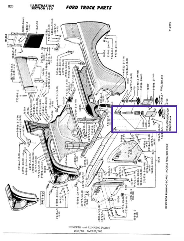

What I am looking for is not shown in this drawing. I'm trying to find the spacer/? that goes between part #16219 and the truck frame. The two rubber pads I have purchased have a circle relieved that fit the spring cups #8131. My old truck had two square fiber looking pads between #1629 and the frame.
