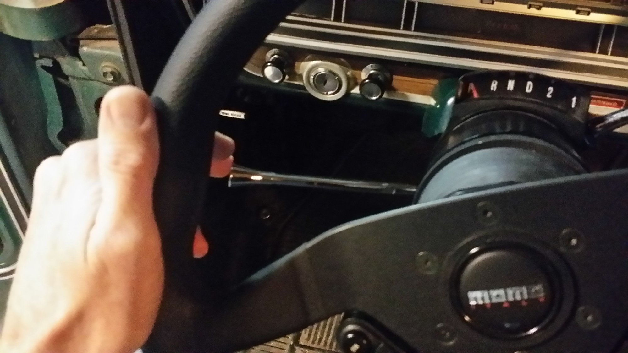

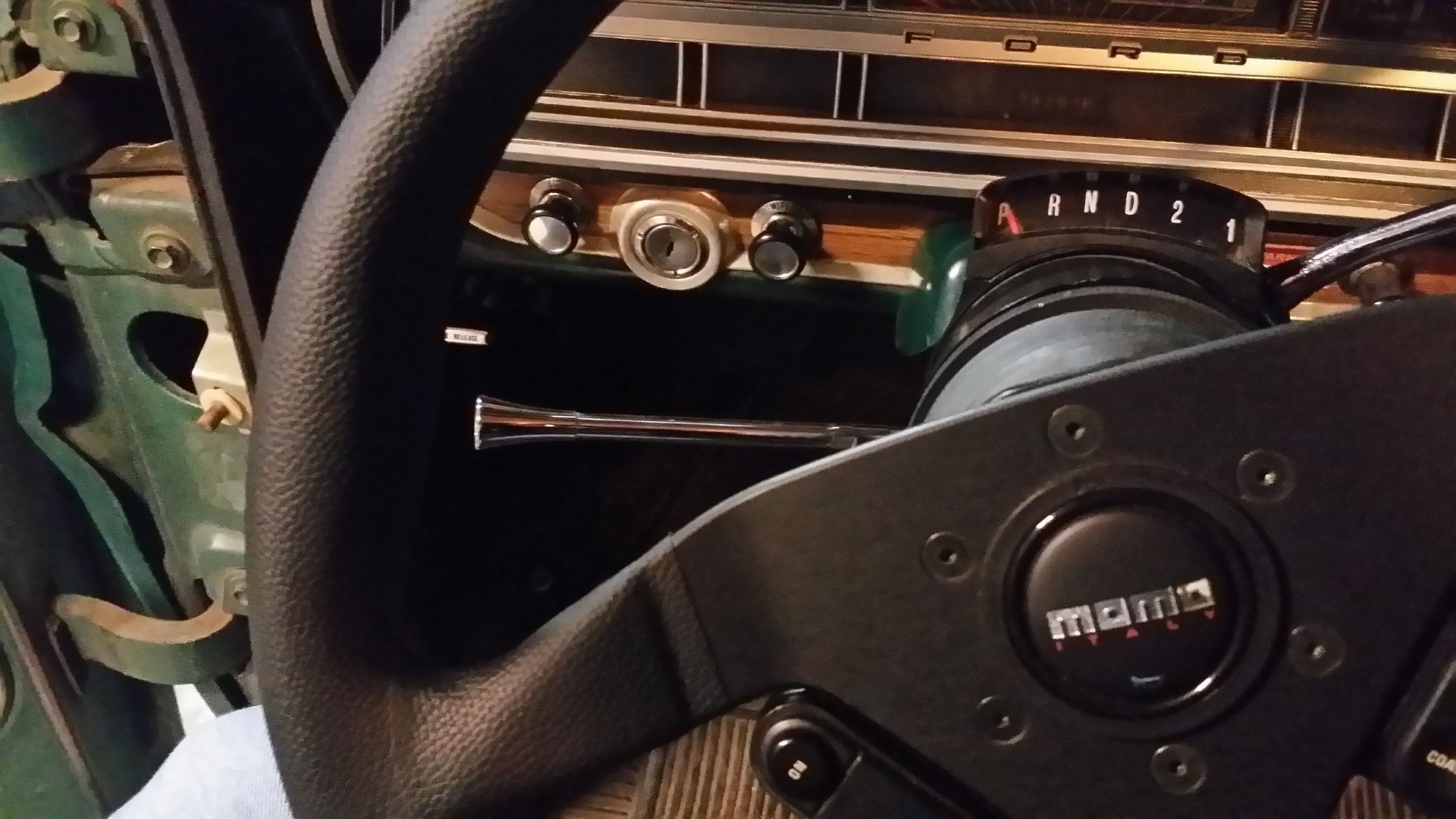

I had the opposite problem on my truck. The blinker lever was too long, after I swapped to a steering wheel that was 3" smaller in diameter than my stock '69 steering wheel.
I installed a blinker lever that was 2" shorter than my '69 blinker lever.
....just a finger tip's reach away from the steering wheel.
Length of my old blinker lever compared to the shorter replacement blinker/tilt column lever.
I'm not certain what the threaded diameter and pitch is on the tip of the blinker lever, since a 1/4"-20 or 1/4"-28 die doesn't seem to want to thread up on the tip (?). Unless you can find a vehicle with a steering wheel greater than 17" in diameter, I don't know that you'll find a stock blinker lever longer than the one you already have.
