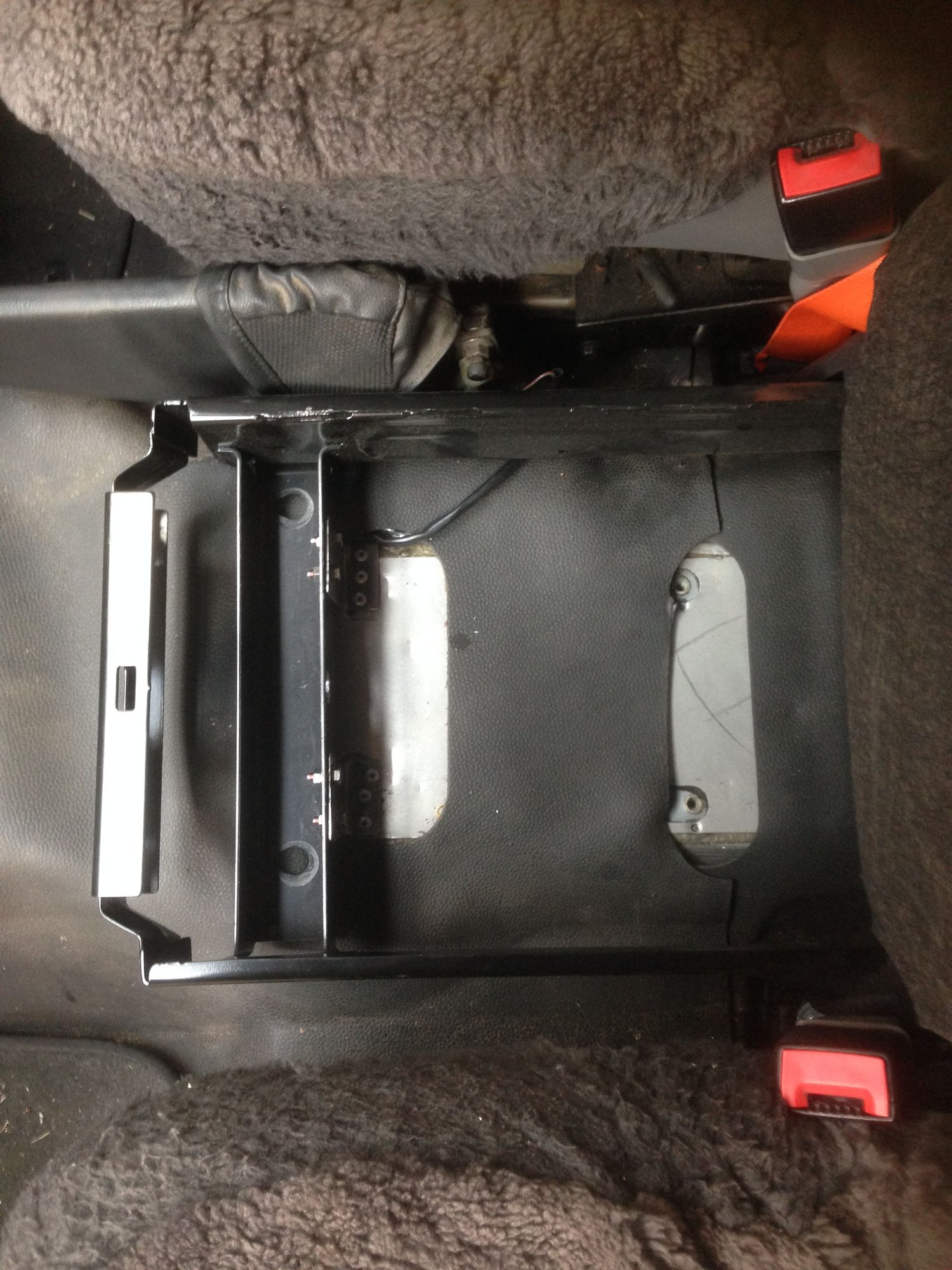

Jump seat install:
from above, jump seat frame. I made the front mounts from some RSJ riveted to the floor & bolted to the frame. Just clears the handbrake

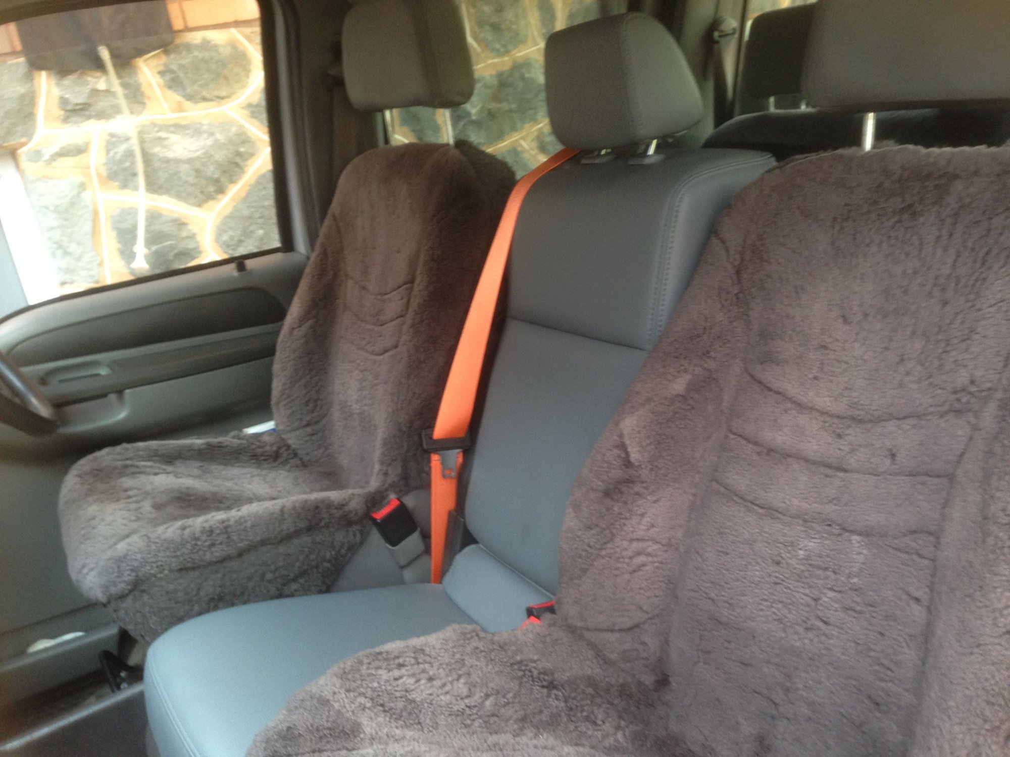

Jump seat deployed
Handbrake - tight fit but operational without hinderance
Integrated seatbelt - the orange colour means there'll never be a mix up during normal operations
