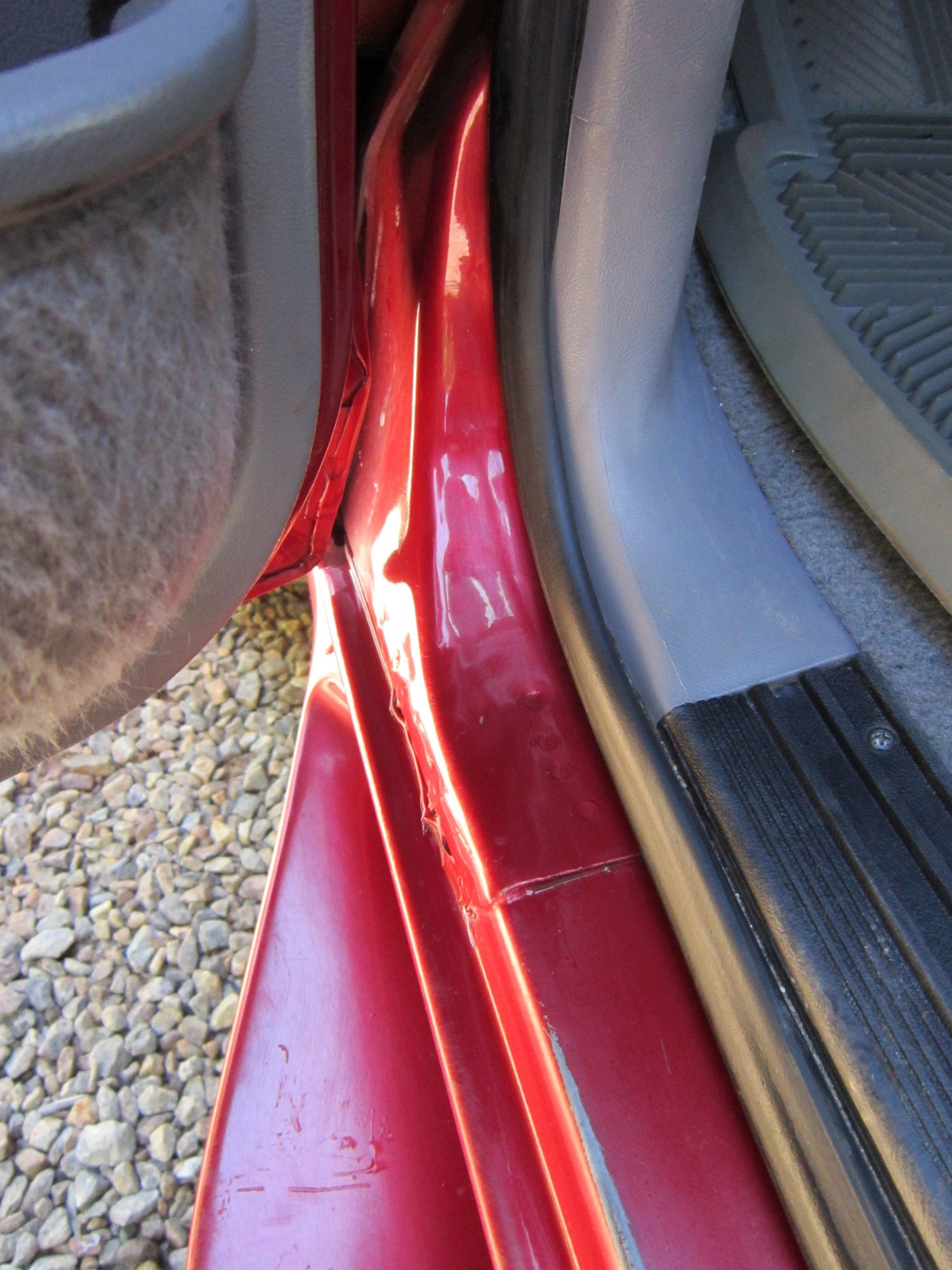

I'm going to take it to "The Guy" and have it looked at. The truck is so nice I'll do what ever it needs to fix it. Here's a picture of it. Not quite like being there!

Man, That is one clean truck. Obviously, being from N.C., it's probably never seen any road salt. That's a good thing!

We're in the Smokey Mountains. Although we do get some snow here there's not much on the ground at any given time. The snow melts in a day or two. Some times there is no snow at all! They don't sand and salt either, except for the major rts.
