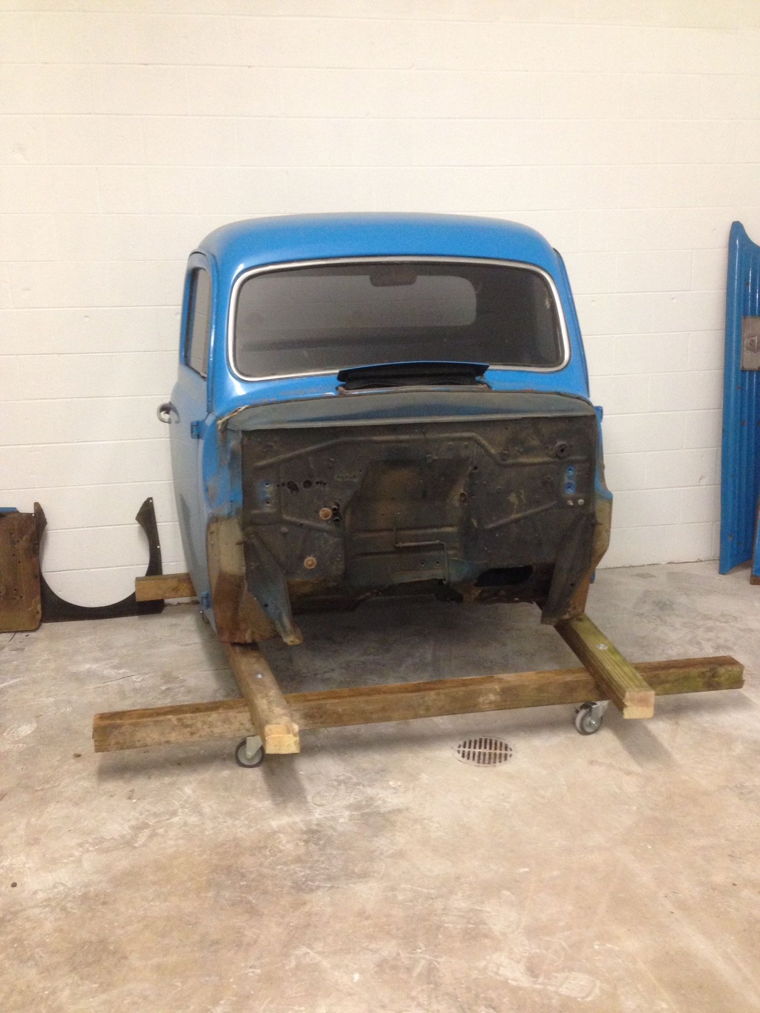

I just bolted 4 car skates to a piece of 5/8 plywood 4x6 so I could roll it on to its back by my self

Here is a pic bed is on it now
I just let the cab sit on it without the horses, the horses are for the bed to have it higher

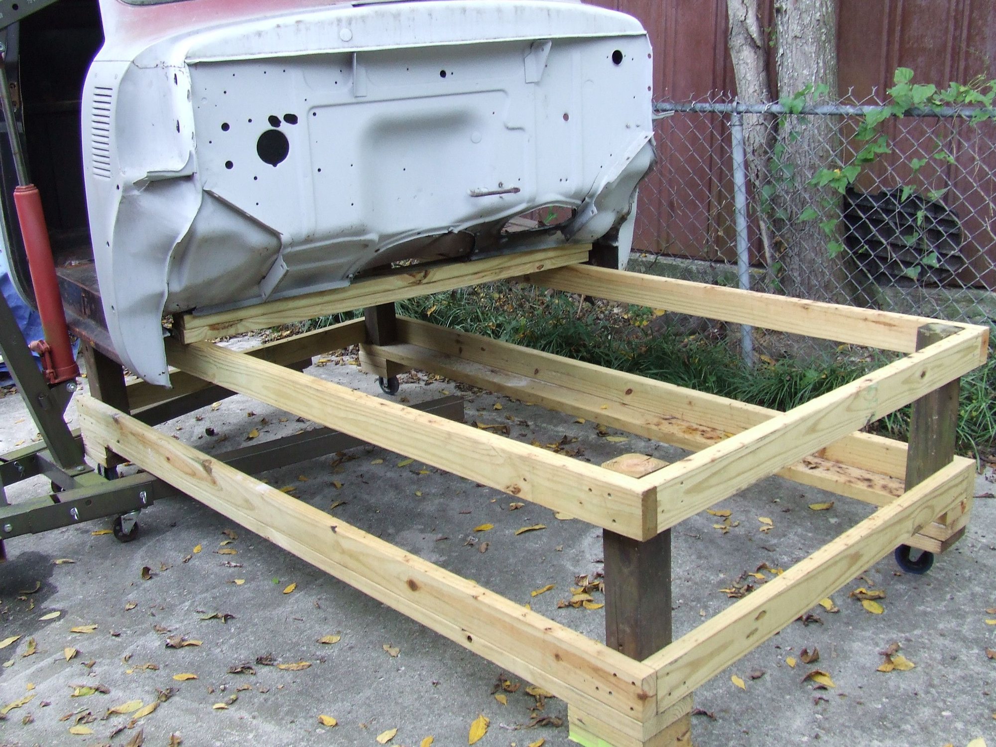

Mine looks like this:
