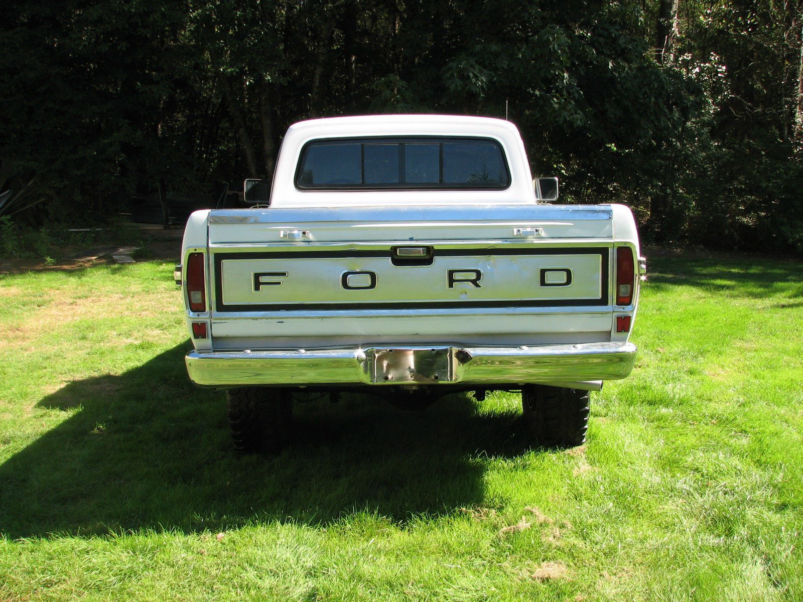

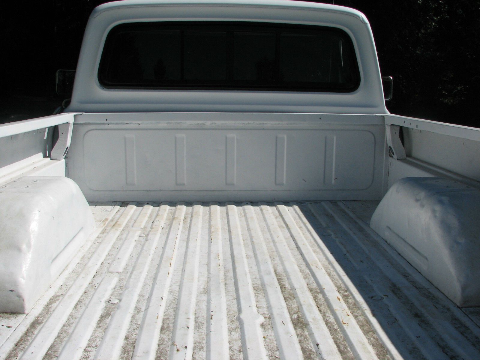

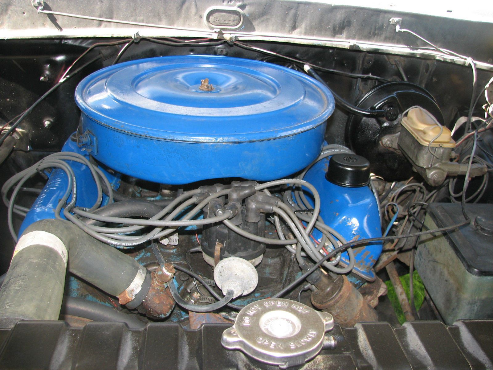

1972 Ranger XLT - Thoughts?
Just purchased from WA. Bringing it down to NE this week.
I am fairly new to this generation of Ford Trucks, so please let me know what your thoughts are.
Definitely not a showroom truck, but the body looks fairly straight.
360 with the 4 Speed - 116k miles
4x4
Power Brakes
Rust on Lower Front Fender
What would be the first projects you tackle with this vehicle?
What would you change/restore?
Let me know if there is anything you dislike about the truck.
Thank you.

The first thing is, I'd do is add a spare tire. Then would be changing all fluids & hoses. Pull all four drums and check brakes look for any leaking wheel cyl. Repack all wheel bearing. Check all 3 rubber flex brake lines for any cracking and replace them if old & hard. Check & lube front driveline u-joint's. Do a compression test before a full tune-up
Just so you'll have something to do for starters!

FYIs...
- The tie downs are retrofitted. New replacements are about $40... each!
- The truck has a "contour" rear bumper. OEM brackets are relatively hard to find.
- Side view mirrors have been retrofitted.

Also check the cab mounts. Metal fronts and rubber front and rear. Back of the cab looks low.

Can this Tailgate Trim be repaired / straightened out?
The 70-72 Ranger Tailgates seem to be extremely hard to find.
Thanks,
Trever

I have the same panel, and mine is a little beat up also I'm going to try and straighten it out, I think you just have to be very gentle.
