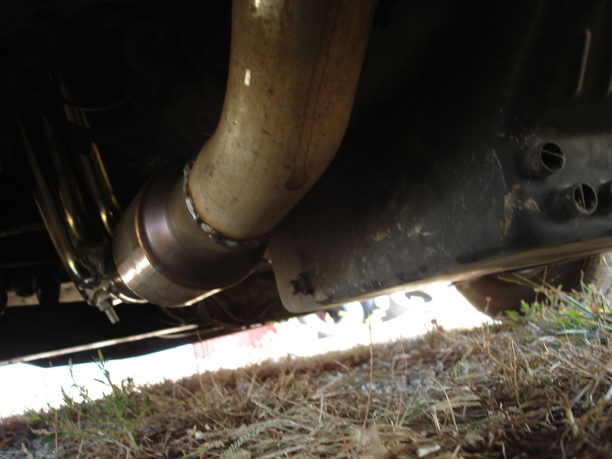

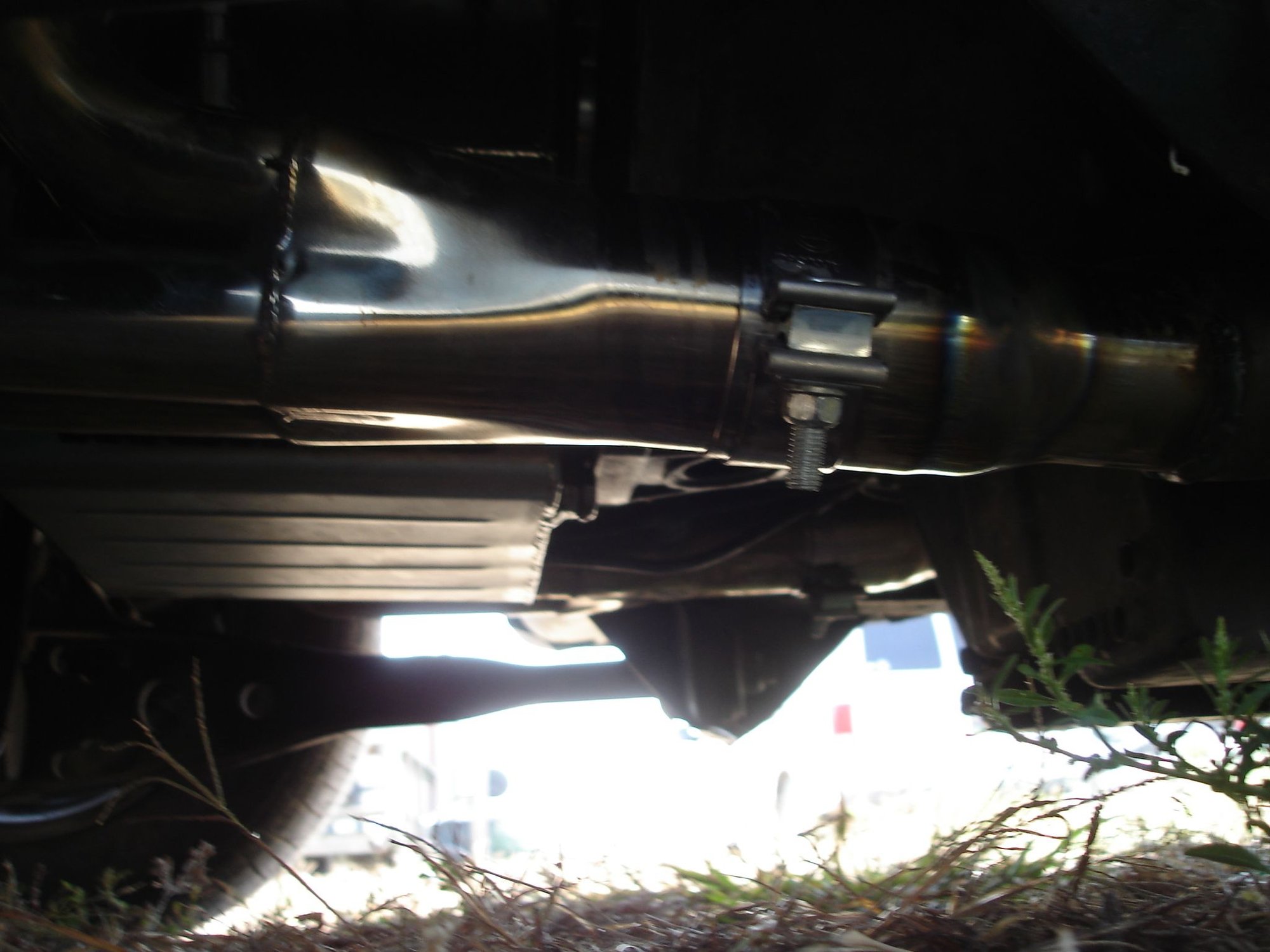

Why I think it might be the oxygen sensor placement.... I have it currently in the Driver side Long Tube header....Currently running true duel exhaust....
The bung for the passenger side header is about 1/4" to high and the sensor hits the Trans casing lip....I could grind a small piece off the lip....
Any ideas?
Sorry about the terrible pictures....Cant crawl under truck with out jacking it up.

The O2 sensor location is not your problem. You may have a worn throttlebody, a sticking IAC valve, or a bad TPS sensor.

I?dle surge typically isn't o2 sensor. You could unplug the sensor and see if that's your issue, but I've never seen an o2 sensor not function when it's in the header...that's plenty close enough.
What headers are theY
