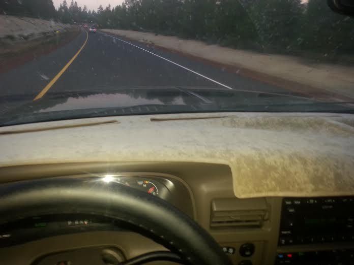

protective cover, must go

Interior is a 9/10! Leather is perfect, everything works as it should (except the DVD player, has a DVD - Back to the future- stuck in it and wont eject, wonder how long that been in there>? haahaha) First "MOD" removing these hideous carpet kit that is covering the dash/center console..

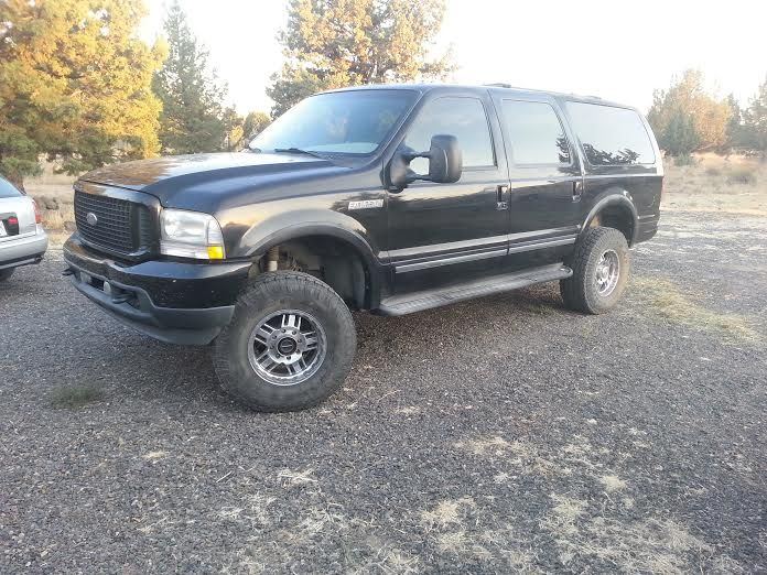

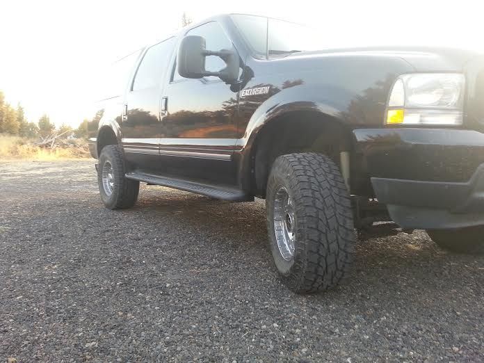

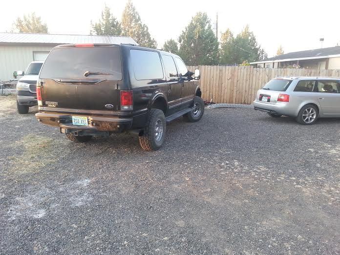

Paint is decent, some spots are in good shape, some spots are "10 footer", there is some paint fading, and some clear coat peeling, some bad paint. Mostly toward the top/roof, and the rear doors are faded- are they fiberglass? Front bumper has dent on it- saw new bumpers for 150.00 so was not a deal breaker, or might be a good reason to upgrade to a deer mover?
Tires 35x12.5x 17, Toyo= 85% tread left. Lift on it appears to be a little dated, springs have Sky Jacker on it, there appears to be some lift blocks between the leaf springs and the Differential, probably why it rides fairly stiff? Or is the the shocks, cant tell what kind they are? Would like to soften the ride a bit if possible-

2. Bummer about the skyjacker springs, skyjacker is notorious for using way to stiff of spring rates. If it were me a lower spring rate would be high on my list of changes.

Yes, fiberglass.

Protective coversw removed, first mod done!!! lol

Yeah, stiff for sure!! Thought maybe it was the shocks, might have to look into changing spring rate, I was on a few crappy roads on the way home, and it just beat the crap out of me, I was imagining kids trying to nap through that......lol

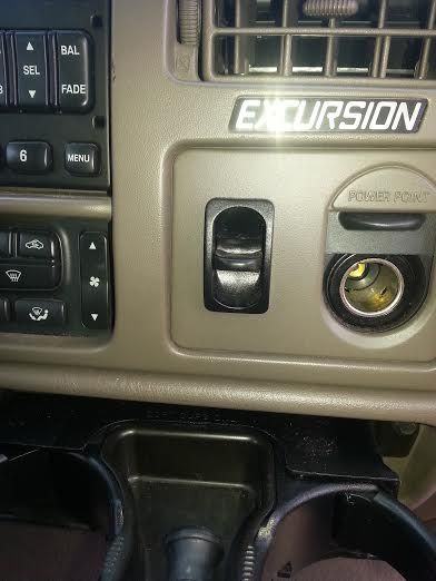

this?
Anybody able to recognize this thing, or have any idea what it is?

Mine has one of those also. It used to be called a cigarette lighter. Now to be politically correct they call it a power point. I use the one in mine to charge my phone.
As for the switch beside it I don't know what that would be. My guess is it was installed by a previous owner.

Yeah, the switch is odd- I can flip it and it makes noise behind the dash, I am starting to think maybe its for the old On board air system? But it there room to put one behind the dash? Thats where the sound comes from?

Yes the shocks contribute to the stiff ride, but it starts with the spring rate.
You need a shock with more compression and rebound dampening in them to control a stiffer spring. You could put on a "softer" shock but if I doesn't have enough valveing it will handle like a water ballon. Maybe go with the rancho 9000 adjustable valveing and see if you can get a decent balance between to stiff and to mushy.
