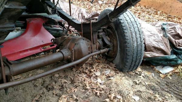

I am picking up a dana 60 out of a 91 f350 to toss under my 87 f250. What parts do I need to do the swap correctly? By way of sway bars, tie rods, pitman, idler, and anything else you can think of. Also what will remain the same? My truck doesn't have a lift on it so no hassles there. Also the axles only have 3.73 gears and they are going under my diesel. I am looking to put a stronger gear ratio in and was wondering if I should just go with 4.10's or would I be able to fit 4.88's or 5.38's? Firs time doing a swap like this and I just want to know all that I can before I start taking things apart and run into problems. And no I am not planning on using the springs or blocks.

u need to take out them lift blocks
thats the good one a d60 with king pins.
them springs look like V's

You will need....
STOCK F350 pitman arm(the lift one will do you no good)
STOCK F350 front leaf springs(Your F250 ones will do you no good)
STOCKF350 front driveshaft(and front yoke from F350 t-case)
STOCK F350 steering linkage
Drivers side U-bolt plate an new U-bolts
Stock Track bar and mount
Next up... Who put 3.73s in? They were never offered in there trucks. Just 4.10 and 3.55. What size tire do you plan on running and what do you use the truck for?
