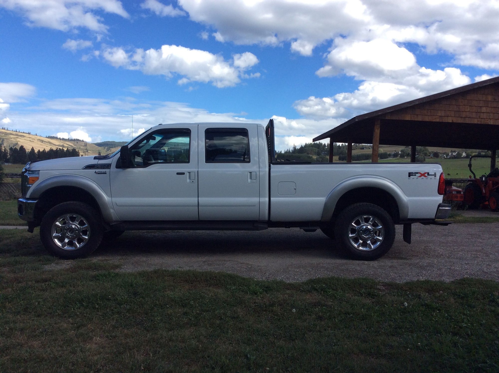

Today was a simple project day. Installed Amber running lights on each leg of the running board.
Simple little add on but makes me happy to see her light up at night

That was the Pilot $20 kit I purchased and popped on there.
Don't laugh, but it took me about 4-5 hours to do. Being that I drilled them into the plastic, I soldered my own ground wire inside the housing (they only have the hot wire coming out and usually the mounting screws ground it out when screwing into metal).
Then came the marking of the holes, drilling, siliconing, moutning, then wiring under the truck. I tapped mine into the rear trailer harness running lights.
Overall, I love it! Simple little kit, simple add on, BIG SMILE!!!
I recommend if you have time to kill and have nothing else to do to the rig, this is a cheap, "wife budget friendly" kit

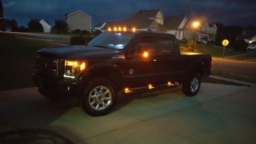

I did the same mod a few weeks ago, except I used the 2 stage LEDs on mine. They will blink brighter when using the turn signals, it also took me about 5 hours to complete this install. They really look nice at night.

I would love to have the cab amber lights...... My problem is I'm too chicken to drill into a perfectly good cab. The worry about leaks would just kill it for me!!
I used the Pilot Amber light kit, so no blinkers I was toying with the idea of wiring them up for blinkers, but then decided I liked the static look more.
