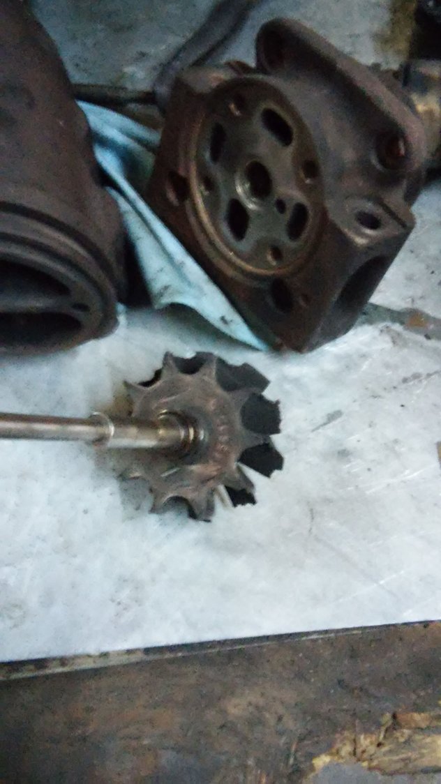

Have you checked your turbine exhaust wheel, im working on one at work the thing looks fine at first glance but in a closser inspection the blades are melted all the way ill take some pic's tomorrow that was the root cause of high egts on this truck

This particular truck was boosting low im going to say 5 lbs less than stock but took forever to do so, at (3200 rpm) and egts skyrocketed. no boost leaks, no exhaust leak, everything checked out till i removed the down pipe and found what you see from my previous reply

I have officially seen 3 burnt up exhaust wheels on stock programmed and injected 7.3s in my life, and that one is the worst by far!
