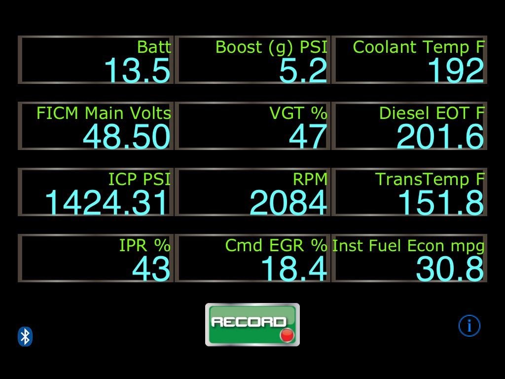

Dashboss monitor
I use the Dashboss with my IPad using Bluetooth.
Totally programable for the user as you can see half of the metrics I monitor on this page. There are 12 other parameters that you can also monitor on the gauge style settings.
Here's my digital page.
Here's page one of three of the gauge style.
