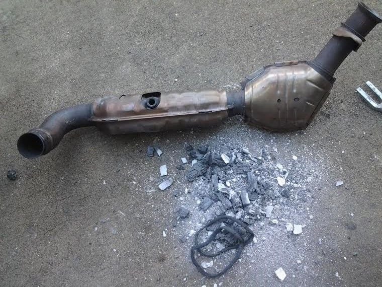

Ok so I dropped the cat on the driver's side today and found lots of nice burned up material. Hollowed it out and put back on. Started truck up and still making pinging fuel noise of the fuel going into the cats. I am going to drop the passenger side cat and do the same. However now I have no idea why it seems like it is not getting spark or fuel. The #2 cylinder, which is the culprit, is reading 190 PSI on the compression test. I put back the motorcraft ignition coil and old spark plug wires. I believe I have it wired correct. The spark plug wires are 1-2-3 on the left side of the coil and 4-5-6 on the right hand side of it. Fuel pressure or injector issue?

Rule out fuel because that is what burned the cats from what was injected and not burned in the cylinder.
A 30X code is a 'secondary' side of the coil failure or no spark.
It is not the computer or harness leading to the coil or there would be a 35x code for that 'primary' side of the coil circuit.
You have to have a coil secondary side failure, the plug wire or a boot/plug fault.
There is no other place to look.
At least do some testing on the spark plug lead off the engine to ascertain if you even see any spark across a plug tip laying on ground.
Is there a possibility your not seating the plug wire onto the coil or on the plug? Remove the injector plug when you do this so fuel is not pumped out of the plug hole and ignited.
Resistance test the plug wire with an Ohmmeter. You should see 5000 to 10,000 ohms resistance range.
Look at the spark plug tip after running the motor a few minutes. Is it wet with fuel that would indicate an injector stuck open and fouled the plug?
Is the plug gap in spec range?
Be sure your working on the second cylinder from the front on the passenger side for code 302..
Good luck..

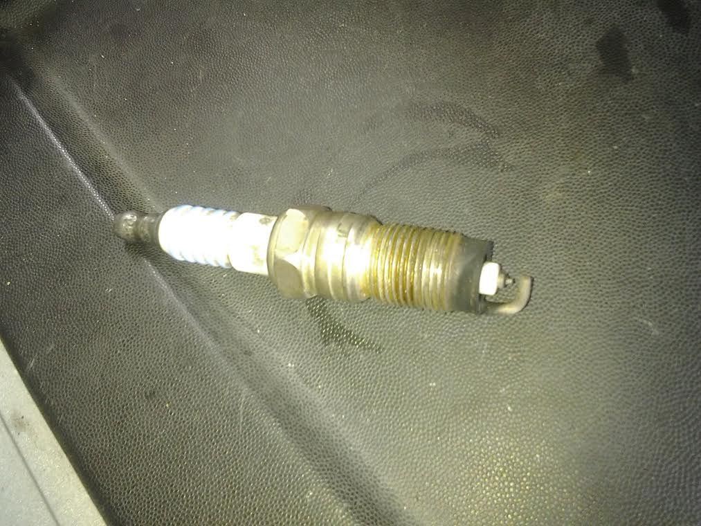

Here is a picture of the #2 cylinder spark plug. I checked the connection on the spark plug wire and everything appears ok. Truck is still running really bad. I have not been able to remove the other side Catalytic converter on the passenger side due to not being able to access the bolts that mount it to the exhaust manifold. Truck is still making "pinging" noises from the exhaust due to the fuel being burnt. Still running P0174 code. Cleaned MAF sensor again but that made no difference as some had said that the P0174 code could be attributed to that. Going back to the auto parts store to get another spark plug. I am running out of time as my wife needs the truck for work tomorrow and I am driving the Bronco. This is PURE craziness!
