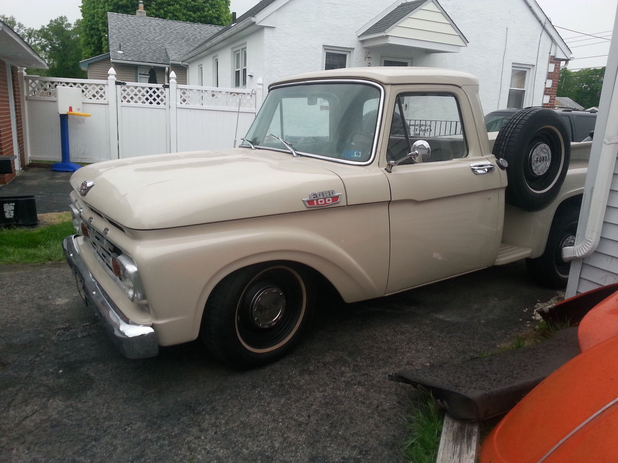

I have only done the front end as of yet but it was a dramatic drop in my opinion. I plan on doing the rear in the next couple of days. I just did a flip on the leaf. I did need 7.5" half inch squared U bolts up front and only got 7" round U bolts in the rear.
