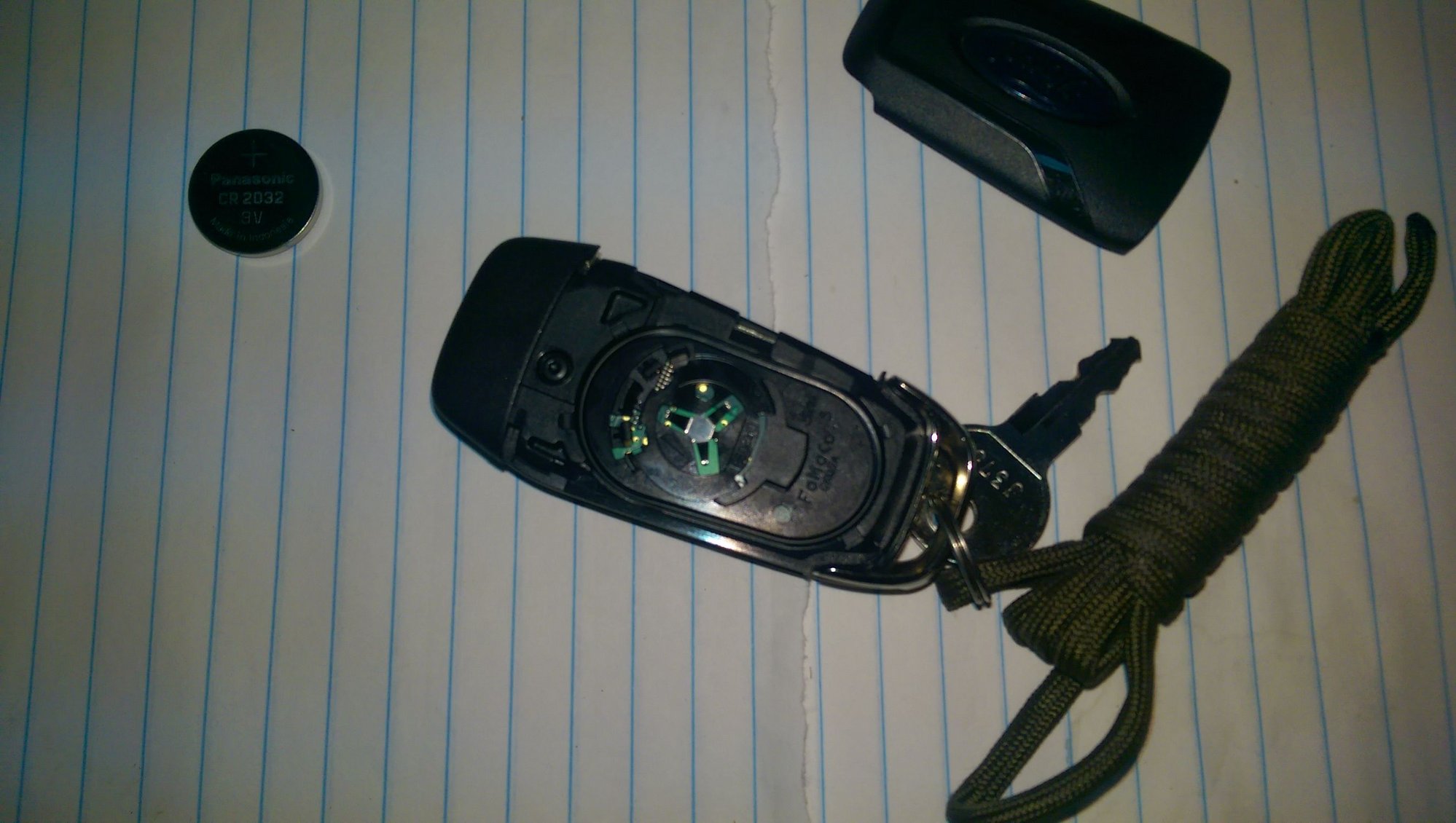

I don't recall removing any torx screw. I removed the battery and then just gently pried up the little module. The silicone rubber template thingy is right there.

The whole fob separates into a couple pieces.

Does yours look like this??

I think so, just pop that module out.

Problem Solved - open the fob and then use a jewelers screw driver to pry up the little module inside the key fob. Inside there is a silicone rubber layer with little rubber nubs that push against the tiny micro switches. I simply snipped off the nub for the panic button. It will never be a problem leaning on the fob and accidentally setting off the horn, due to the panic button being pressed.
