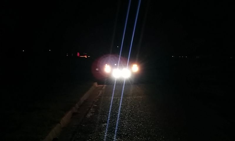

I put my 2 Rigid Dually LED aux lights on a relay that turns them on with high beams, turns them off on low beams and when the ignition is switched off. They work good...almost TOO good. The pics here dont do them justice....they light up the road for at least a half mile. These are small enough they dont block the airflow at all.

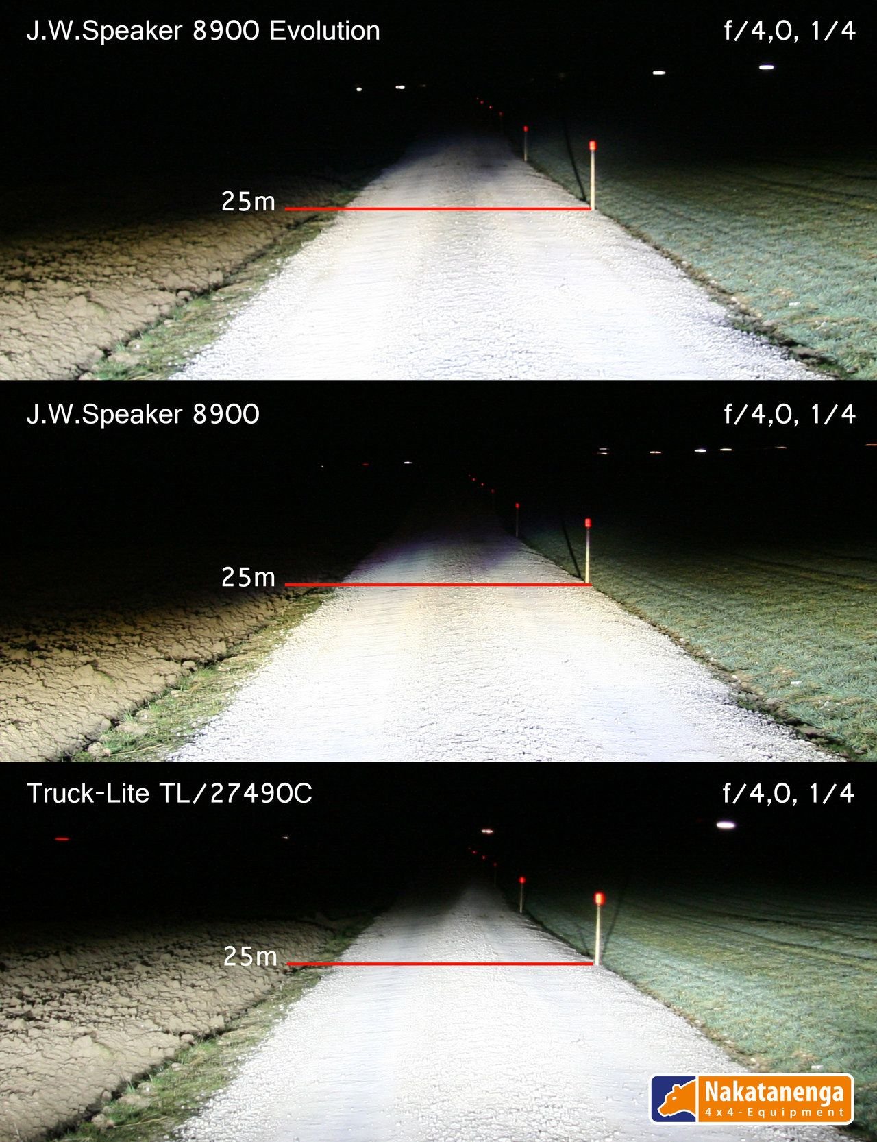

Hey KarstenP, not to derail this conversation further, but do you happen to have any night output shots of the Trucklite LED headlamps? They look to be a quality replacement, but I have not seen them in action.

Not my pictures, but funny enough my headlights when they where still mounted in my buddys Jeep XJ Pictures by Jan Liska
low beam
high beam
Old Jul 21, 2015 | 03:46 PM
REDOVAL's Avatar
REDOVAL
Joined: Apr 2012
Posts: 43
[QUOTE=KarstenP;15517109]Not my pictures, but funny enough my headlights when they where still mounted in my buddys Jeep XJ Pictures by Jan Liska
Thanks, looks like good light for a 4x6 replacement.
