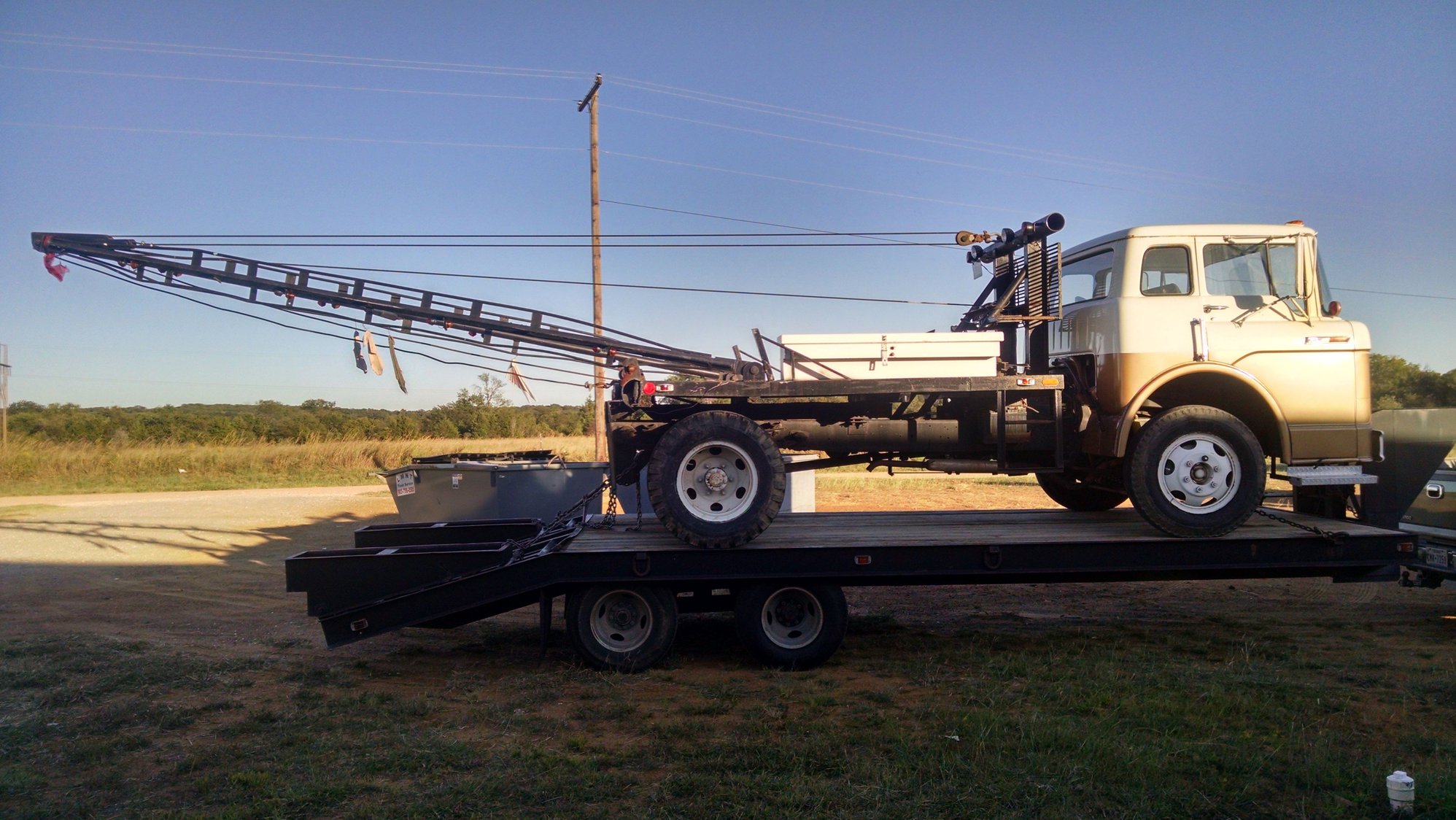

Think I figured it out. The picture loading part. That turned out to be the easy part. Not the real problem.
These are pics from when we brought it home.

Old Girl 54 f600's Avatar
Old Girl 54 f600
Joined: Aug 2014
Posts: 25
Wow, that is a REALLY great looking cabover! I like the two-tone paint. I also love those old boom trucks and would love to have one for my collection some day, although I don't know what I would do with it.
