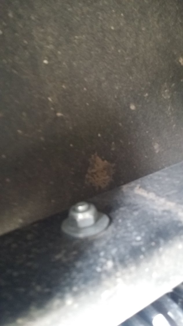

Posts: 338
Top side of hitch
Bottom side of hitch
I used some of the nuts and washers that were included in the box. I made a trip to Ace and bought a longer bolt. Maybe 40 mm.
I used the outer most holes on the bottom side of the hitch that are roughly 3/4 of an inch. Then using that hole, I had to drill through the top side of the hitch bracket, just large enough for the bolt. Which I think is 3/8ths.
Run the bolt through the bracket, then use one of the nuts to hold it to the bracket, and to help space the light low enough to clear the bumper. You will need to buy a large enough washer to cover the hole on the bottom of the hitch.
Run you bolt through the top and then finish with a small washer and I personally bought Ny-lock nuts to not worry about them loosening from bouncing around.
