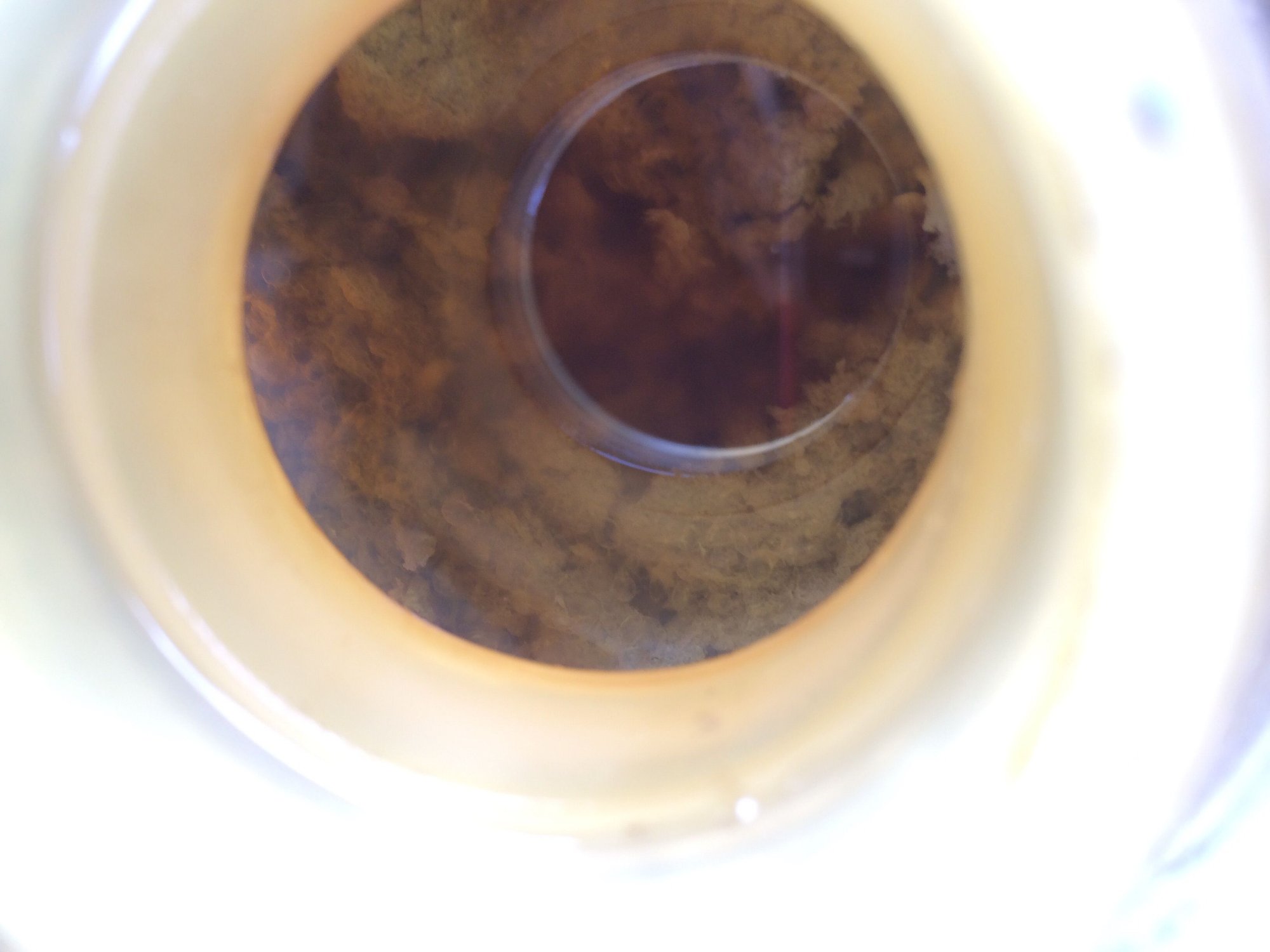

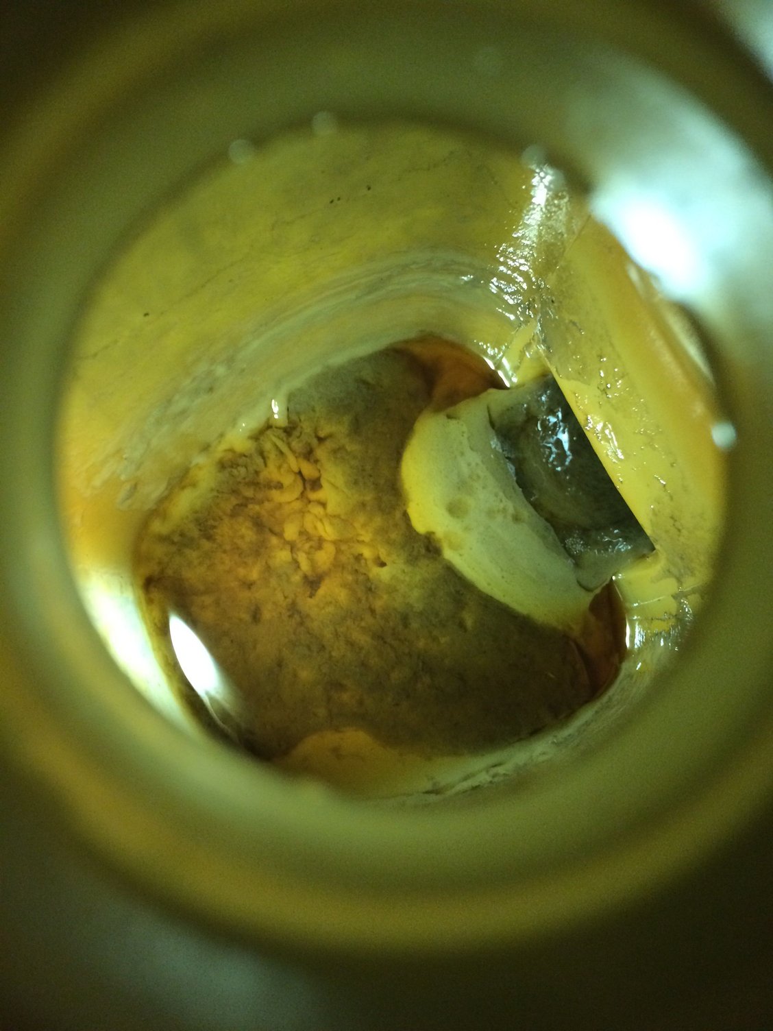

Hi guys, I recently purchased a 2002 f350 7.3 powerstroke 2x4 dually ambulance from the FDNY with 142k. The engine seems to take a bit longer than it should to start, either hot or cold, But it runs great once started. I wasn't planning to keep it but after driving it to the west coast I decided to try and fix the little issues. I notice a bit of white/grey smoke for the first couple minutes when the engine is cold but it clears up. Also I noticed something that seems to be floating in the top of the coolant overflow bottle, it doesn't look like oil. It could be diesel? See attached photos. I got a scanner and have p1211 and p1105 codes. The check engine light only comes on if I'm flooring it and the ipr duty cycle goes above 50 or so. As far as I know, the truck is not chipped but I'm not sure.

Weird stuff floating in the coolant
Had an upper radiator hose failure and caught this white stuff in the coolant bottle
