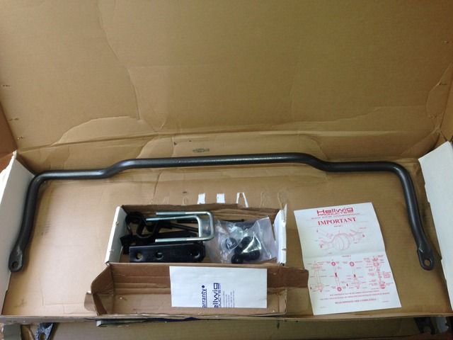

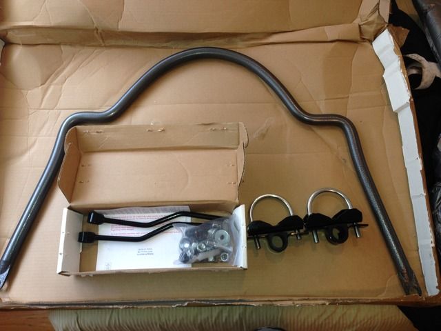

a couple of boxes just turned up on my doorstep - I am getting all barred up!
Looks like the front bar does away with the original attachment point at the front axle, and instead has a couple of clamps and brackets to attach the bar.
The rear bar is a big heavy mother
Yep--that's the main reason I opted for Hellwig over any other available brands. Widening the attachment points seems a better idea to me plus how Hellwig makes the I-Beam connection does away with the poorly designed bushings which are a known weak spot, requiring frequent new bushings in order to maintain the OEM sway bar's operation
Yeah it is----gave me a feeling of confidence it would do the job just fine! Do be VERY careful when/if you have to enlarge or drill new holes in the drivers side frame for the vertical mounts---there are a few important lines and wiring tucked away inside the frame rail where the thru-bolts will go. I almost butchered my fuel and brake lines my first time installing those pieces.
Once both are installed remember to drive a few hundred miles then re-check all bolts and nuts----they will loosen up a bit over time.
On another note after about 7 years driving my front link bushings wore out---Kevin from Hellwig sent me a complete replacement kit free of charge despite me wanting to pay. Can't really beat service like that so long after my original purchase.

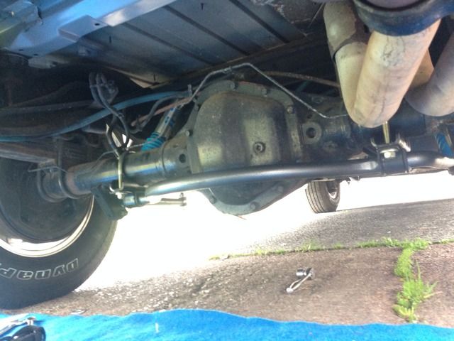

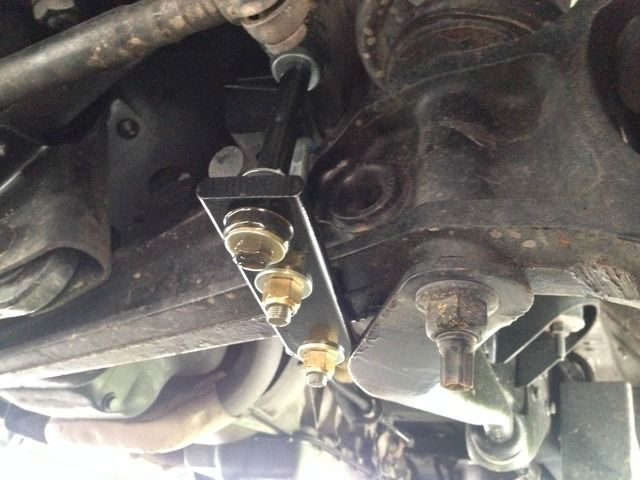

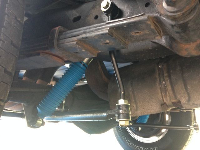

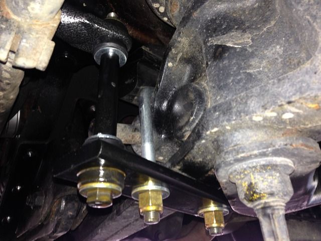

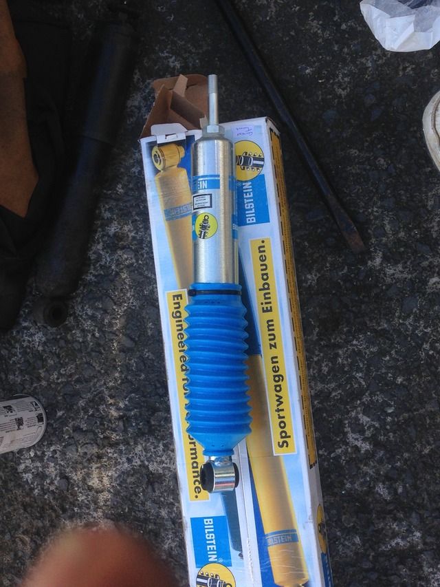

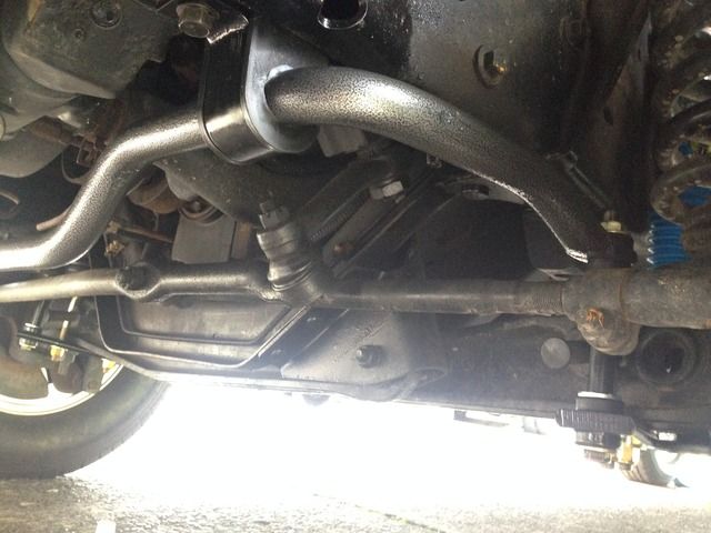

Have just installled the Hellwig bars, and the front Bilsteins. Wasn't too difficult, I needed to enlarge the mounting holes in the rear chassis for the vertical links (checked for loom and brake pipe clearance JWA! ) and I shortened the front U bolts and rear vertical links quite a bit, as there was a lot of the threaded portion hanging out past the end of the nut. Some of the flat washers were on the large side, so I went to my local bolt shop and bought some that were better suited. But these were minor details, and fit and finish was very good overall.
Front Bilsteins:
Some pics of the front bar installed, note that the original mounting holes/bushes are not used, instead a "U" clamp is attached to the front axle, to which the plate/bushes are attached.
And the rear:
Took it for a good test drive around some twisty country roads - OMG what a difference! Previously you would turn into a corner quite early, wait for the first big lurch to settle, then hang on for a rather uncomfortable ride as it leaned and wobbled its way around. I can imagine passengers would have suffered sea sickness on a long trip, it was quite awful! Now it is so tight, and body roll is barely noticable, if at all. The Bilsteins have certainly tightened up the damping, maybe a little harsher over big holes, but I can live with that, it is much better when hitting dips/bumps in straight ahead driving and doesn't hit the stops like it used to. I could follow cars driving at reasonable speeds through twisty roads, and keep up no problems.

Did the rear shocks fitted right away ? How could you found exact model for your van ?
Old Sep 10, 2015 | 03:19 AM
conrod's Avatar
conrod
Joined: Feb 2015
Posts: 84
Yes rear shocks fit perfectly, the model number was BSN-33-176840. I just did a search on Summit Racing's website for the correct model.

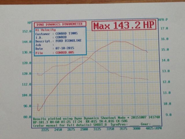

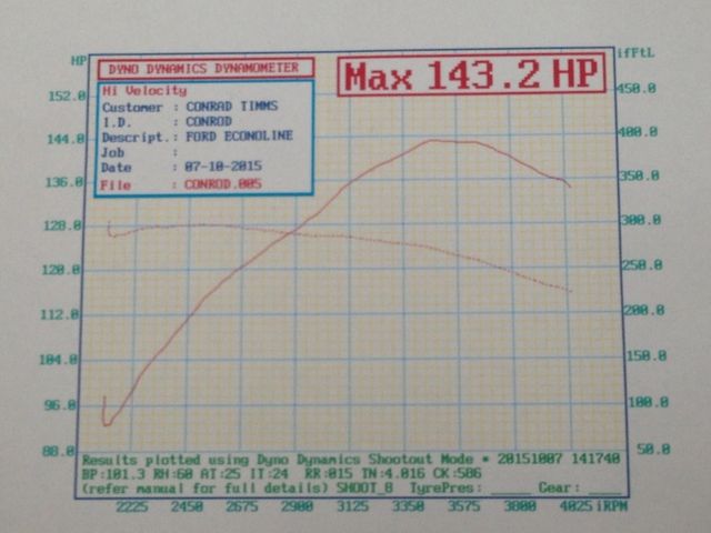

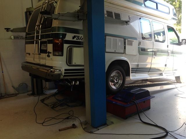

Ran the van up on the dyno, to get a baseline figure before fitting headers, tuning etc. Was quite shocked at how little power it made! 143hp and 300 ft/lbs. at the rear wheels. Did 4 or 5 runs, tried removing air filter snorkel etc. to no difference.
Full throttle setting looks lean around 3000, can anyone tell me what software or programmer I need to recalibrate the ECU? It is a Ford EECIV I think. If it is lean now,it will almost certainly be worse once I fit the headers.

Over in the Modular Motor Forums (mostly V10) Mike from 5 Star Tunes is da man when it comes to writing pretty amazing strategies for that era PCM's.
Not sure he's familiar with your era PCM and re-writing for it but if he's not chances are great he knows someone who could help. Here's a link: https://www.ford-trucks.com/forums/9...ky-thread.html
I'd read all about Mike in the V10 forum then maybe call him---he's always willing to discuss things from what I've read.
