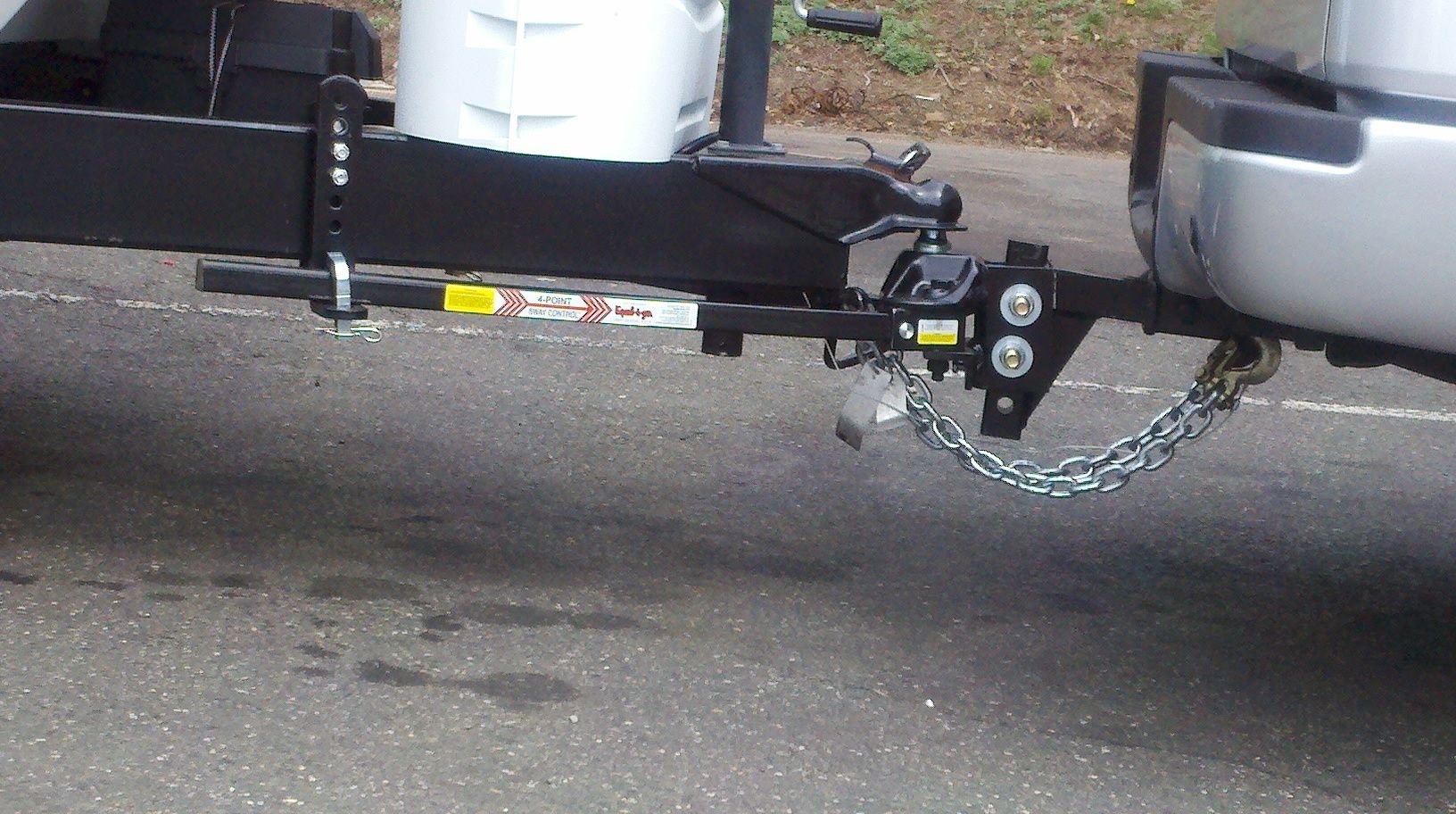

Not sure what you mean by a nut and bolt up front to make tension??? The bars sit on "L" brackets and the higher you set the L brackets the more weight you add and more friction you put on the bars so you have no problems with sway.. Very simple design but very affective! Here is a pic of the hitch setup with my old F150. I towed my 33' trailer thousands of miles without any issues..
It looks good and Thank you for posting the picture.
""Not sure what you mean by a nut and bolt up front to make tension???""
However... you are talking about the rear of the set-up.
What I mean is... Up Front....at the head unit... There is "just" a bolt and a nut holding that bar on (up front) and Equalizer the company stated that, that there is their front tension point.... Like you said "Very simple design".
The other 2 brands "Husky Centerline and the Eaz Trekker" have very different mechanisms (up front) than the Equalizer which just has a bolt and a nut up front vs the other two.
Check out those two and you will see what I am talking about.
That is what I am asking...... does anyone have the EAZ Trekker or the Husky CenterLine hitches on their trailers?
