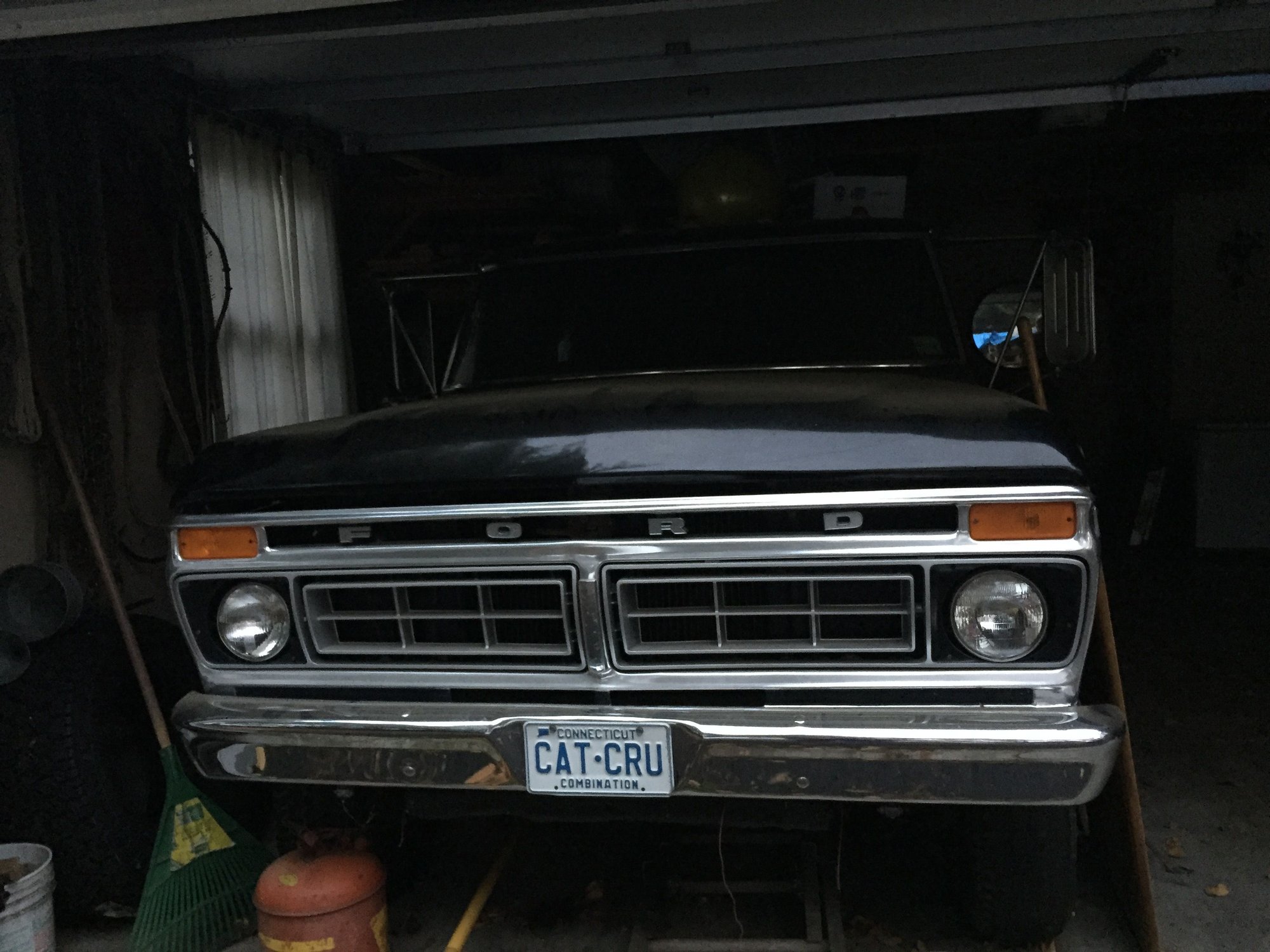

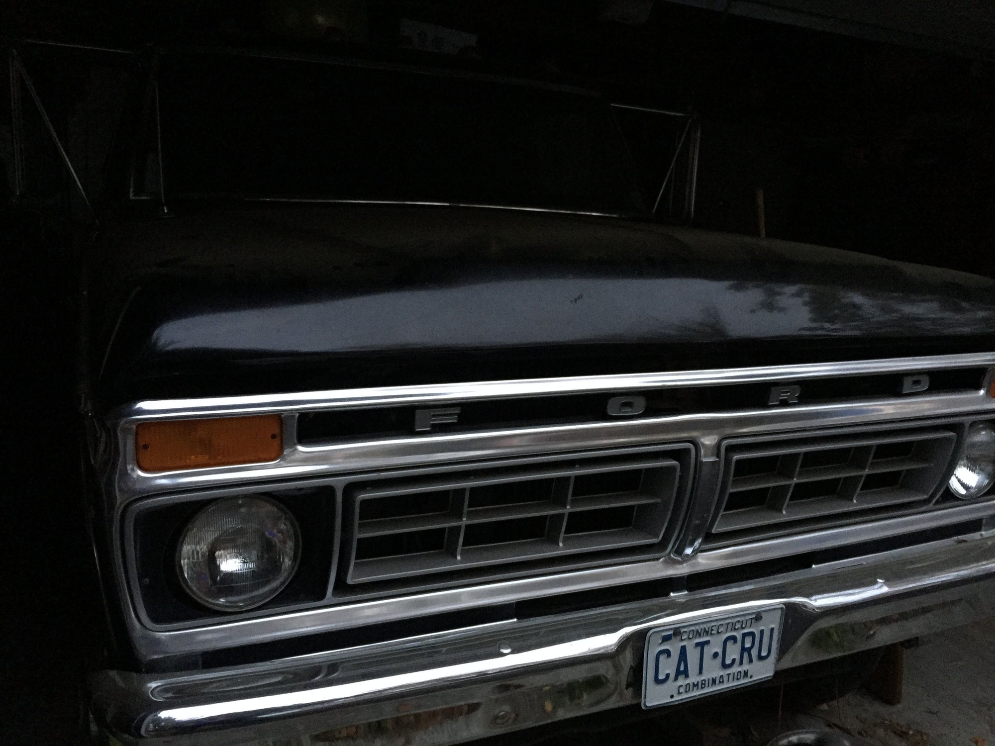

this is a fully restored 76. crew cab 4x4 with 16inch frame added for 8ft bed
has a 427 under the hood. 5 speed manual with overdrive and a dane 70 dually.
been in this garage from the 80`s i couldnt get side pics because the old timer that built it is using t to hold up a few sheets of plywood. used to pull 8 ski doo`s and friends to main in the winter. also has 4 gas tanks 1 in the bed for 120gallons of gas. with a cap. a true beast!
