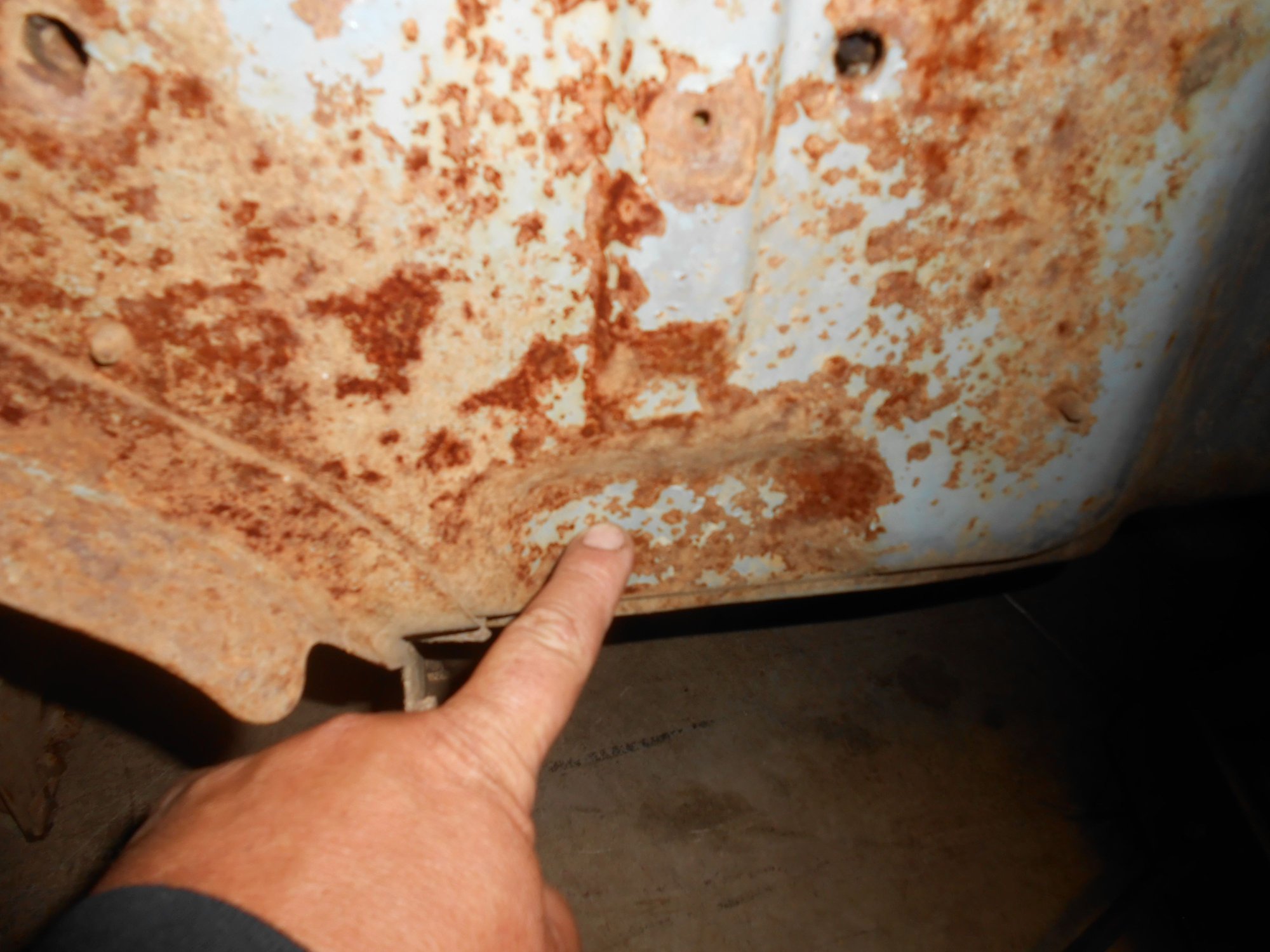

I'm going to say that its a 1953 that has had a Y block installed.
The voltage regulator (that has already been mentioned) is on the correct side for a flat head v8 and a 6 cyl but not for a y block.
Also the earlier cabs (1953) did not have this indent and the truck in question does not have it if you look at the firewall near the exhaust

I also believe it is a 53 with a transplanted Y-block for these reasons: the hood side emblem is a 53 and 54, so that rules out 55 and 56. The heater is a left over from 52. I have never seen this style heater in a 54, 55, or 56 trucks. The instrument panel has gauges for the oil pressure and generator. F-100's starting in 54 had idiot lights not gauges. And of course the grille is a 53 grille with the three pointed star indicating it was a 6 cylinder. Now all of these could have been changed, but that is highly unlikely.
Kevin, interesting point you made, never knew that before.
