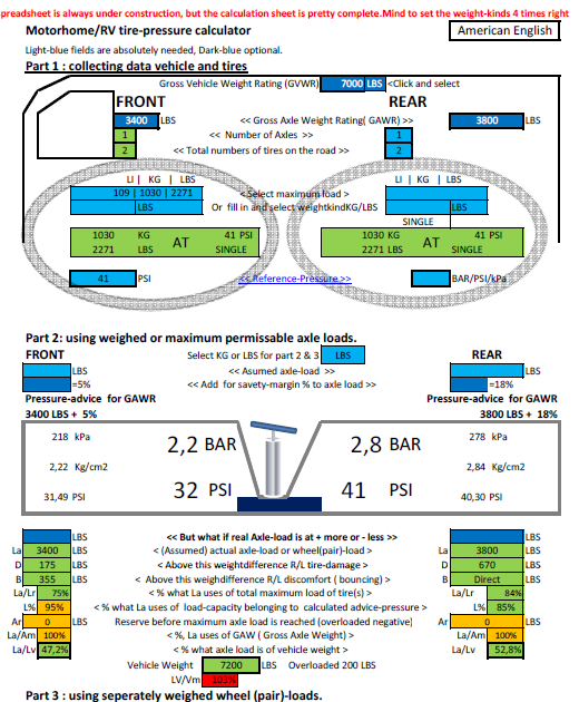

But OK , I filled in my motorhome calculator in LBS ,because American forum I assume, and with conversion you mean built as motorhome I think.
But correct me if wrong somewhere.
Will give the pressures first because having some problems lately producing pictures from my one-drive that belongs to my hotmail.com adress with same username as here ( so jadatis, combine yourselfes if you want to mail me, SPAMM machines cant this way).
Advice 1.
First filled in the GAWR's as given and tire data and gave F 32psi/ R41 psi.
This is highest needed pressure ( if device gives it right that is) with maximum reserve for things like , pressure loss in time, unequall loading R/L, expected overloading Rear, etc etc, but probably still no bumping.
Advice 2.
But also highened up the maximum load by 3 Loadindex steps to get the maximum load for up to 81m/130km/h ( a thing I figured out).
Then it gives F29psi/R37psi So this must be seen as minimum pressure with no damage done to tires up to your 80m/h. So if you measure that cold on the road, and are not able to fill up that moment, dont worry to much.
Advice 3
But also used my determined motorhome standard and that is next.
Substract Rear GAWR from GVWR to get probable weight on front axle.
7000-3800= 3200 lbs on front axle even when fully loaded or even when overloaded.
Left it at advice for 99m/h so maximum savety with probably no bumping, so pressure to fill if you check and are able to fill of 31/41.
The lower the front PSI the more comfort and gripp wich is for frontwheeldrive positive , but also for braking, and to give less nervous stearing. For comfort the front axle you experiënce most because you are sitting pretty close to front axle.
Rear weighing would comfirm that axle weight begins at GAWR for these light trucks, and overloading ,though not allowed , is more rule then exeption. If you then use a pressure yust enaugh for the gawr, nature will punishe with tire damage and mayby blowout, and axidents , and damage to motorhome or worse injured or death people.
so better to high pressure with some bumping, then to low with all the missery that can go with it.
Managed to insert a picture direct from my computer, so see if it works.
Is the first advice so highest needed.

OK then , here the correction with new picture.
Googled the 235/75R15 XL and apeared to be 108 LI , so not that much difference, but need 41 psi for that, because smaller .
Advice 1: 27/35 psi
Advice 2: 25/32 psi
Advice 3: 27/35 psi
And advice 3a is using my motorhome standard and 3 LI steps higher so lowest pressure with probably no tire damage for up to 81m/h.
Advice 3a: 24/32 psi.
And here the new picture of advice 1;
