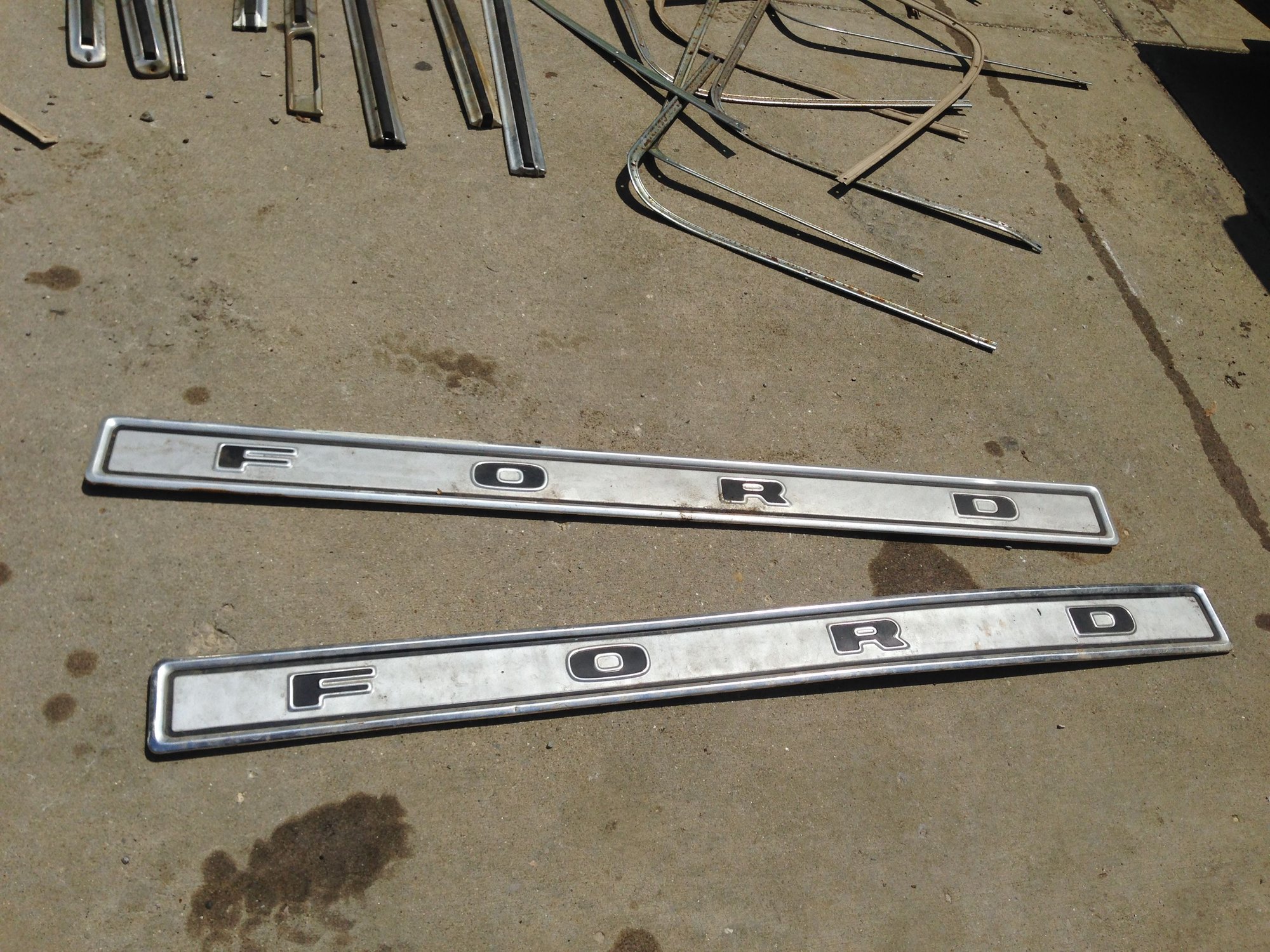

here are the pics of what i got from it
supercab windows, all the dent trim, tail light trim, 2 tailgate trim pieces, horn pad, door panels, 2 bezels, window cranks, emblems, race track trim, ranger xlt glovebox door,headliner trim which is 2 or 3 sets, and the best part...... a clean un cracked dashpad!!
and front axle assembly, t case wheels and tires

Put all that in the classified section and make some project $$$.
Pop open SC windows did you get the cab part hinge? Green door panels $$
