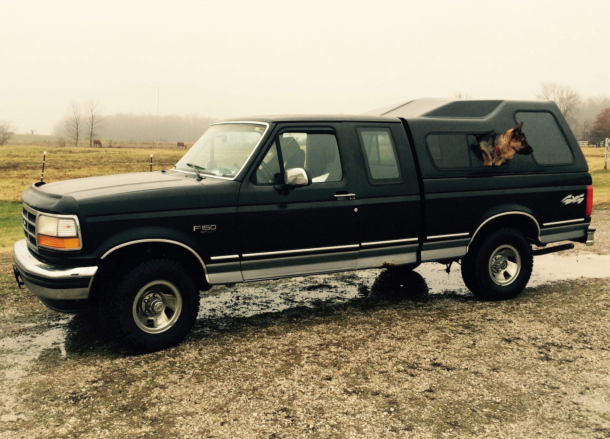

Diagnosing a noise:
Pulling away from a stop you hear/feel a short groan popping sound which is low frequency and repeatable rolling on and off the throttle. brake application doesn't reproduce it.
I originally thought a combo of tired motor mounts and transmission cross member mount. They look structurally intact but will get changed soon.
A local shop mechanic that grew up working in a Ford Dealership shop thinks that large rivets mounting the cross member to the frame rails (or someplace) have worked loose, he said it was typical at this age.
My question being, if this does pan out to be the case, doesn't it make sense to support the frame with the weight off of the suspension then just weld up these areas secured by the rivets?
TIA
