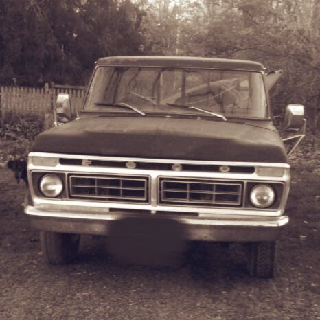

Okay so I have been toying the idea of putting a diesel engine in my 1977 f250 camper special ranger 2wd, but I cannot find any links on it being done on a 2wd. Has anyone tried or know someone who has? And If so please I would love to hear all about it.

I honestly can't say I have seen a 2wd cummins swap here but it would basically be the same swap..
Nice pickup by the way
