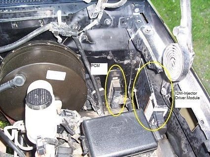

Sorry on the side of the computer
It is inside the engine compartment on the fender.
I didn't unbolt it to see if there are numbers on the back.
should I ?
HB

Not trying to be a *****, but are you sure you are looking at the pcm? The idm is on the inner fender, the pcm is in the firewall..
