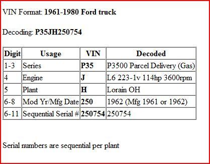

DSO is a District Special Order, it was equipped with something not normal for that model, in your case it MAY be the rear end.
Numberdummy may be able to tell you something about it, but I recall him saying that Ford had tossed all those records years ago.
Also the P code for the paint, there is no truck color associated with a P in 1962, my best guess is that it represented Primer to be painted by the customer or at the dealer.

If you're gonna do that you may want to talk to a local Ford dealer and see if they can help with "official" Ford paperwork. If nothing else, you might get them to print the decode on their letterhead. DMV may be able to check the records and find that the 5 was a typo somewhere along the way. After all that seems to be the only difference 52 instead of 62.

Thanks,It gets worst i never compared my title to data plate.Now looking at the two my title vin # is completely wrong.Thanks again for your help.The mystery thickens.

You are most likely correct. Harleymsn decoded my data info after I started this thread and cleared up a lot of facts.My van isn't a 52 has I thought but a 62. I need to find serial # to find more info.

Warranty Number: P35JH250754
P35 = P350 Parcel Delivery.
J = 223 1V I-6.
H = Lorain Ohio Assembly Plant.
250754 = 1962 Numerical Sequence of Assembly, the P350's specific serlal number (assembled January 1962).
The OP is aware, as he listed this Warranty number 5/24/2015 in the 1961/66 forum, I decoded it there.
1953/66 F350 & P350 came with 6 lug wheels on a 7.25" bolt circle.
Here's the Warranty Plate decode:
104" Wheelbase.
P = Prime.
MODEL P350 = P350 (gas) .. 8,000 lbs. GVWR
TRANS E = Borg-Warner T-87E 3 Speed Manual.
AXLE 26 = Spicer/Dana 60 rear axle / 4.88-1 / 5,000 lbs. Rear Axle Capacity.
8,000 lbs. Gross Vehicle Weight Rating.
114 net HP @ 3,600 RPM
5105 = Domestic Special Order number. The vehicle was painted a non standard color, and/or something was installed "special" after the truck left the assembly line.
FoMoCo THREW AWAY all the records decades ago, so there's no way to find out what this 5105 DSO invoice number represents.

I read that only 8 lug rear ends came with the Dana 60. And my rearend is a 6 lug. My data plate shows a Dana 60.

Yes, I got most of that in a later post the same day except that I didn't have the decode for the axle and trans.
Originally Posted by harleymsn
Well, I knew that plate was not from the era of our trucks, here is the breakdown
