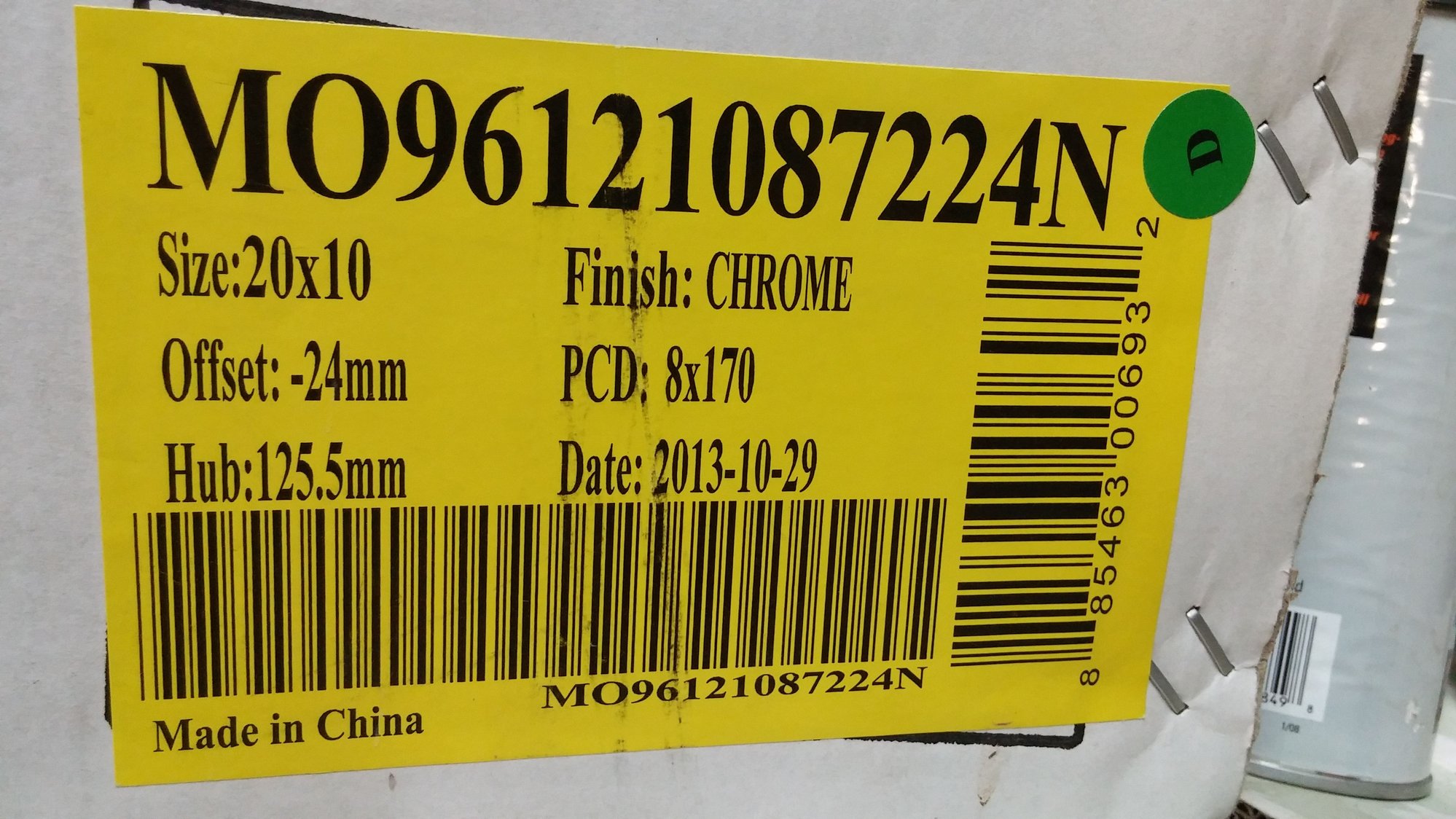

What offset are other years capable of? I got a set of 20x10 -24 offset I bought to use on my truck, but since then have changed my mind. Looking for what years it would work on before I post for sale on craigslist.

Looks like a Moto Metal part #. With that width and and that offset, those wheels a definitely designed for a lifted truck. The 8-170mm bolt pattern will fit back to 1999.

Yea they are for a lifted truck, and recommended drop pitman arm. I know the bolt pattern works from 99+ 250's, but the offset is what I'm wondering what they will work on. They will push the wheels out on my 2000, and that will be the same through 03-04. The 05+ are pulled in a little from the 2000 that's why spacers are needed to run new wheels on older. So is this offset enough to make these also work on 05+?
